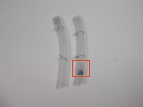

  6. Hamilton Beach 49980A Water Tubes Replacement, Water Tubes: crwdns2935265:06crwdnd2935265:01crwdnd2935265:01crwdne2935265:0
    • locate the bottom two spring clamps on the tube attached to the base of the coffee maker. Pinch these clips while pulling up to release the tube from the base.
    • Pliers will make this task easier
  7. Hamilton Beach 49980A Water Tubes Replacement: crwdns2935265:07crwdnd2935265:01crwdnd2935265:02crwdne2935265:0 Hamilton Beach 49980A Water Tubes Replacement: crwdns2935265:07crwdnd2935265:02crwdnd2935265:02crwdne2935265:0
    • After pushing the clips down, pull the tube from the base. This may be difficult, so use a spudger to pry the tube off as you hold the base down.
    • When replacing the water tubes, be sure to remove the apparatus from the tube on the right and insert it into the new tube.
