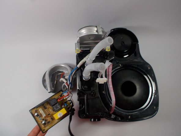

  2. Hamilton Beach 49980A Small Heating Component Replacement, Motherboard: crwdns2935265:02crwdnd2935265:01crwdnd2935265:01crwdne2935265:0
    • Once the bottom plate is removed, use a PH1 bit to remove the .525 inch long screws holding the motherboard bracket in the main housing.
  3. Hamilton Beach 49980A Small Heating Component Replacement: crwdns2935265:03crwdnd2935265:01crwdnd2935265:02crwdne2935265:0 Hamilton Beach 49980A Small Heating Component Replacement: crwdns2935265:03crwdnd2935265:02crwdnd2935265:02crwdne2935265:0
    • Using a PH1 bit, remove the two .425 inch long screws holding down the white power cord bracket. This will give you the slack in the wire that you need to work on the motherboard.
    • Carefully remove the large white connector that has multiple wires attached to it. This is the wire connected to the button functions on the interface of the coffee maker.

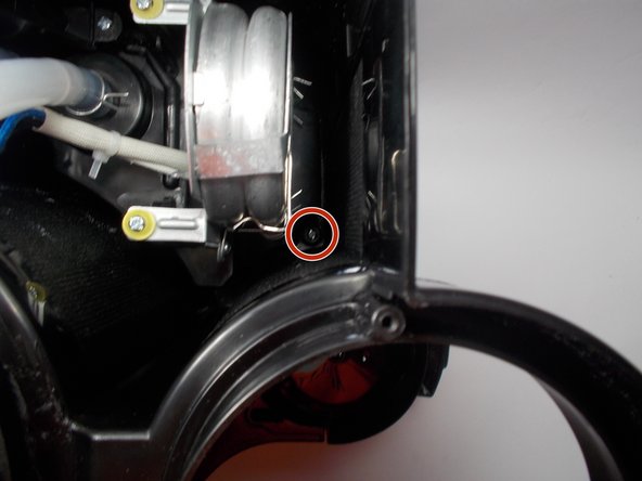

  4. Hamilton Beach 49980A Small Heating Component Replacement, Main Housing: crwdns2935265:04crwdnd2935265:01crwdnd2935265:01crwdne2935265:0
    • After removing the motherboard. Proceed to remove the inner housing which holds the excess power cord. This can be removed by using the PH1 bit to remove the .525 inch long screws that hold the housing in the main housing.
    • This step is crucial because if this inner housing is left attached, the power cord will bind between the two pieces that slide past each other during removal of the main housing.

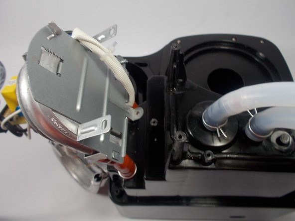

  5. Hamilton Beach 49980A Small Heating Component Replacement: crwdns2935265:05crwdnd2935265:01crwdnd2935265:03crwdne2935265:0 Hamilton Beach 49980A Small Heating Component Replacement: crwdns2935265:05crwdnd2935265:02crwdnd2935265:03crwdne2935265:0 Hamilton Beach 49980A Small Heating Component Replacement: crwdns2935265:05crwdnd2935265:03crwdnd2935265:03crwdne2935265:0
    • Use a long screwdriver with the PH1 bit to access the screws holding the main housing to the top of the machine.
    • Pull main housing up and be sure to run all of the inner parts through the cavity at the bottom. This may take a few tries since components can easily get caught on each other

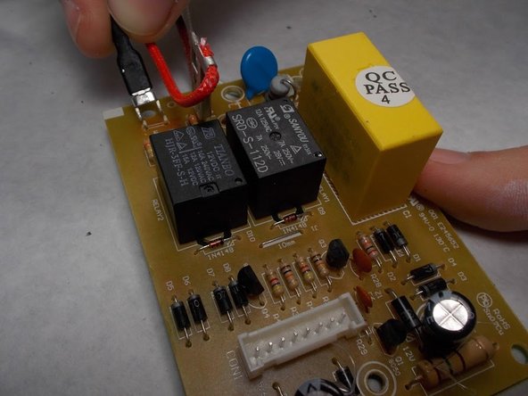

  11. Hamilton Beach 49980A Small Heating Component Replacement: crwdns2935265:011crwdnd2935265:01crwdnd2935265:03crwdne2935265:0 Hamilton Beach 49980A Small Heating Component Replacement: crwdns2935265:011crwdnd2935265:02crwdnd2935265:03crwdne2935265:0 Hamilton Beach 49980A Small Heating Component Replacement: crwdns2935265:011crwdnd2935265:03crwdnd2935265:03crwdne2935265:0
    • First, remove the blue wire from the motherboard. This wire will have a black connector on the end connecting to the motherboard. It is found here. Heat up the solder on the bottom of the circuit board and remove the wire from its connection.
    • The wire will be hot. You may want to use pliers to remove it.

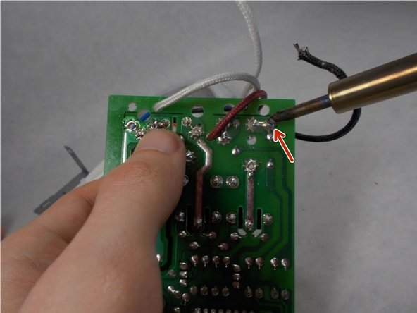

  12. Hamilton Beach 49980A Small Heating Component Replacement: crwdns2935265:012crwdnd2935265:01crwdnd2935265:01crwdne2935265:0
    • Next, on the underside of the motherboard heat up the soldered connection of the white wire. This wire is located in the top corner.
    • Both heating component's white wires are located next to each other. make sure you remove the correct wire for your heater.

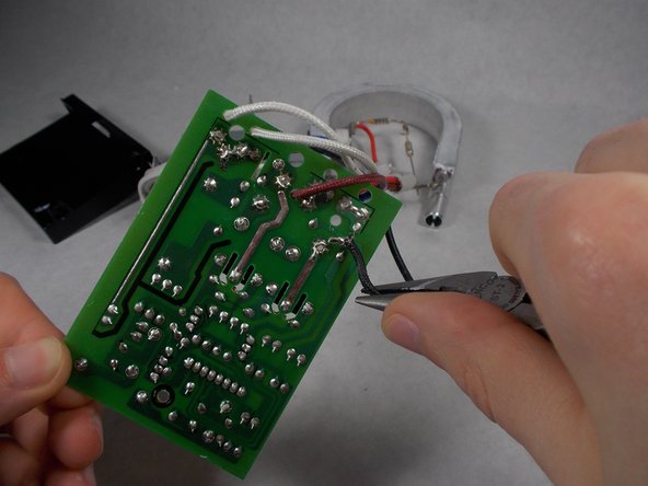

  13. Hamilton Beach 49980A Small Heating Component Replacement: crwdns2935265:013crwdnd2935265:01crwdnd2935265:02crwdne2935265:0 Hamilton Beach 49980A Small Heating Component Replacement: crwdns2935265:013crwdnd2935265:02crwdnd2935265:02crwdne2935265:0
    • Lastly, on the bottom of the motherboard heat up the soldered connection for the black wire. While the solder is melted, remove the wire from the connection.
    • When replacing any soldered components, you may want to apply new solder.
