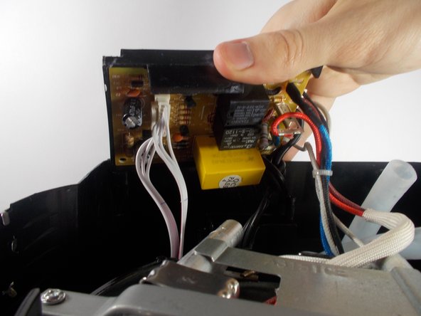

  2. Hamilton Beach 49980A Large Heating Component Replacement, Motherboard: crwdns2935265:02crwdnd2935265:01crwdnd2935265:01crwdne2935265:0
    • Once the bottom plate is removed, use a PH1 bit to remove the .525 inch long screws holding the motherboard bracket in the main housing.
  3. Hamilton Beach 49980A Large Heating Component Replacement: crwdns2935265:03crwdnd2935265:01crwdnd2935265:02crwdne2935265:0 Hamilton Beach 49980A Large Heating Component Replacement: crwdns2935265:03crwdnd2935265:02crwdnd2935265:02crwdne2935265:0
    • Using a PH1 bit, remove the two .425 inch long screws holding down the white power cord bracket. This will give you the slack in the wire that you need to work on the motherboard.
    • Carefully remove the large white connector that has multiple wires attached to it. This is the wire connected to the button functions on the interface of the coffee maker.

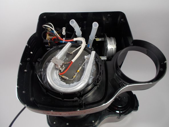

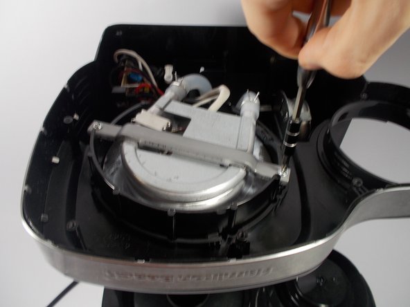

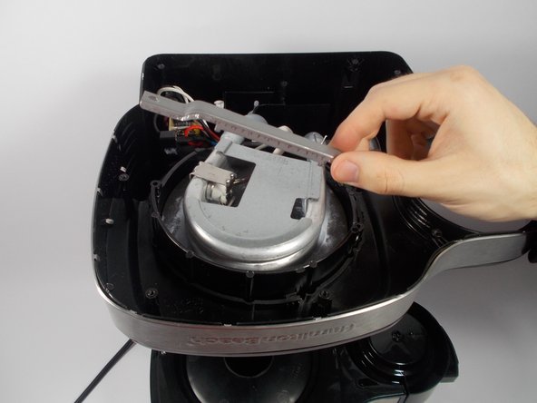

  4. Hamilton Beach 49980A Large Heating Component Replacement, Large Heating Component: crwdns2935265:04crwdnd2935265:01crwdnd2935265:03crwdne2935265:0 Hamilton Beach 49980A Large Heating Component Replacement, Large Heating Component: crwdns2935265:04crwdnd2935265:02crwdnd2935265:03crwdne2935265:0 Hamilton Beach 49980A Large Heating Component Replacement, Large Heating Component: crwdns2935265:04crwdnd2935265:03crwdnd2935265:03crwdne2935265:0
    • Remove the two .374 inch long Philips head screws from the brace using a PH1 bit and take the brace off.
  5. Hamilton Beach 49980A Large Heating Component Replacement: crwdns2935265:05crwdnd2935265:01crwdnd2935265:01crwdne2935265:0
    • Remove the second brace.

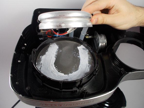

  7. Hamilton Beach 49980A Large Heating Component Replacement: crwdns2935265:07crwdnd2935265:01crwdnd2935265:03crwdne2935265:0 Hamilton Beach 49980A Large Heating Component Replacement: crwdns2935265:07crwdnd2935265:02crwdnd2935265:03crwdne2935265:0 Hamilton Beach 49980A Large Heating Component Replacement: crwdns2935265:07crwdnd2935265:03crwdnd2935265:03crwdne2935265:0
    • With the spring clamps moved down, slide the tubes from the ends of the large heating component. Once the ends are free, separate the component from the hot plate.

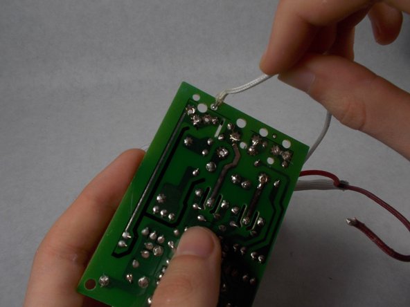

  9. Hamilton Beach 49980A Large Heating Component Replacement: crwdns2935265:09crwdnd2935265:01crwdnd2935265:02crwdne2935265:0 Hamilton Beach 49980A Large Heating Component Replacement: crwdns2935265:09crwdnd2935265:02crwdnd2935265:02crwdne2935265:0
    • Solder the brown wire connecting the large heating component to the motherboard and remove it.
    • The wire and all following wires will be hot, so use pliers to safely handle them.

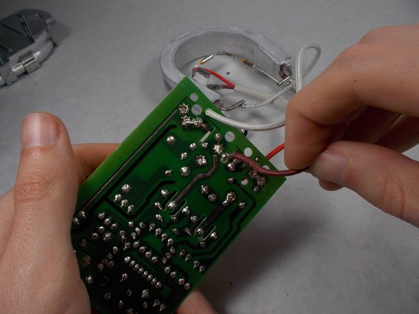

  10. Hamilton Beach 49980A Large Heating Component Replacement: crwdns2935265:010crwdnd2935265:01crwdnd2935265:02crwdne2935265:0 Hamilton Beach 49980A Large Heating Component Replacement: crwdns2935265:010crwdnd2935265:02crwdnd2935265:02crwdne2935265:0
    • Solder the white wire connecting the large heating component to the motherboard and remove it.
    • The wire will be hot, be sure to use pliers
