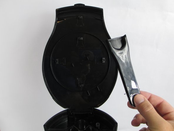

    • Carefully open the top lid of the Brew Station.
  2. Hamilton Beach 48464 Tubing Replacement: crwdns2935265:02crwdnd2935265:01crwdnd2935265:01crwdne2935265:0
    • Slide out the filter basket that is sitting on top after opening the lid.

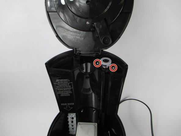

  3. Hamilton Beach 48464 Tubing Replacement, Tubing: crwdns2935265:03crwdnd2935265:01crwdnd2935265:02crwdne2935265:0 Hamilton Beach 48464 Tubing Replacement, Tubing: crwdns2935265:03crwdnd2935265:02crwdnd2935265:02crwdne2935265:0
    • Using the Philips 2 Screwdriver, unscrew the two 8-mm screws labeled in a red outline.
    • Once screws are removed, pull off the little circle piece.

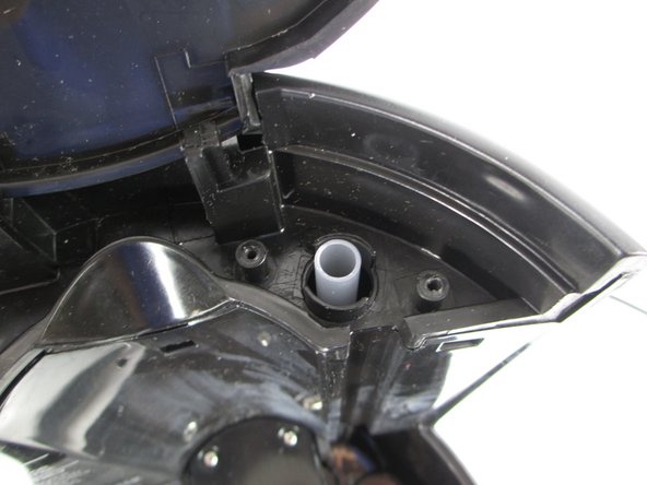

  4. Hamilton Beach 48464 Tubing Replacement: crwdns2935265:04crwdnd2935265:01crwdnd2935265:02crwdne2935265:0 Hamilton Beach 48464 Tubing Replacement: crwdns2935265:04crwdnd2935265:02crwdnd2935265:02crwdne2935265:0
    • Using tweezers, grab the tube that is exposed after you pulled the piece off in step 1 and pull it up and out of the Brew Station.

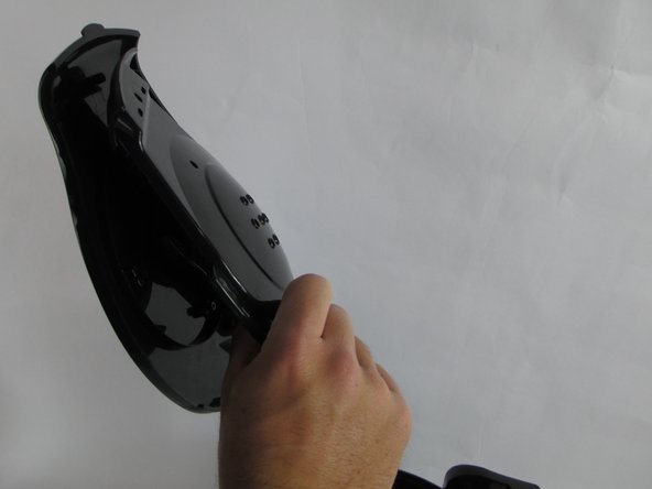

  5. Hamilton Beach 48464 Tubing Replacement: crwdns2935265:05crwdnd2935265:01crwdnd2935265:02crwdne2935265:0 Hamilton Beach 48464 Tubing Replacement: crwdns2935265:05crwdnd2935265:02crwdnd2935265:02crwdne2935265:0
    • Using the Philips 2 Screwdriver, unscrew the three 8-mm screws labeled in a red outline.
    • Once screws are removed, gently pull off the liner that is on the inside of the lid.
