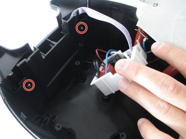

    • Using one hand, hold all cords away from the front end of the Brew Station.
    • Using your other hand, use the Philips 2 Screwdriver to unscrew the two 8-mm screws labeled in a red outline. They are located inside the base on the front end of the Brew Station.

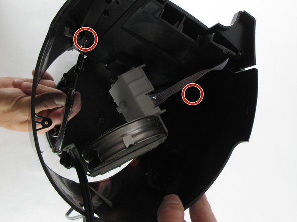

    • Once the screws from the previous step are out, you will be able to grab the bottom half of the Brew Station and lift it up.
    • You will not be able to lift the bottom half all the way off because it is still connected by cords
    • Use one hand to lift up the bottom half of the Brew Station and use your other hand to unscrew the two 8-mm screws labeled in a red outline with a Phillips 2 Screwdriver.
    • The screws are in line with the position of the screws from the previous step, but they are lower.
    • Getting to the screws is difficult, so it may be useful to have someone help you. Also, the pictures show 2 different methods for getting to the screw (entering through the base or entering through the gap after lifting the Brew Station apart).

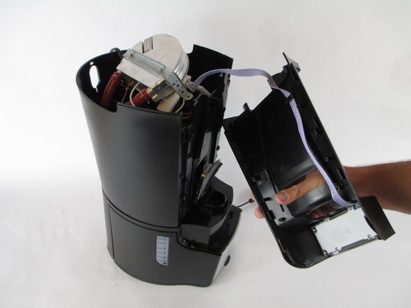

    • Hold the base of the Brew Station with one hand and hold the front panel with the other.
    • Gently pull the front panel away from the rest of the unit until it pulls away completely and is only attached by the purple wire.
