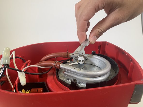

    • Unscrew the two 12 mm screws from the bar that holds the heating element in place using the Phillips #1 screwdriver.
    • Use your other hand to push the heating plate out of its place.

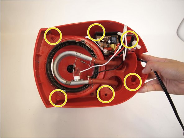

  4. Hamilton Beach 43253R Disassembly: crwdns2935265:04crwdnd2935265:01crwdnd2935265:03crwdne2935265:0 Hamilton Beach 43253R Disassembly: crwdns2935265:04crwdnd2935265:02crwdnd2935265:03crwdne2935265:0 Hamilton Beach 43253R Disassembly: crwdns2935265:04crwdnd2935265:03crwdnd2935265:03crwdne2935265:0
    • Remove the ten 13 mm Phillips #2 screws that connect the base of the machine to the upper segment.

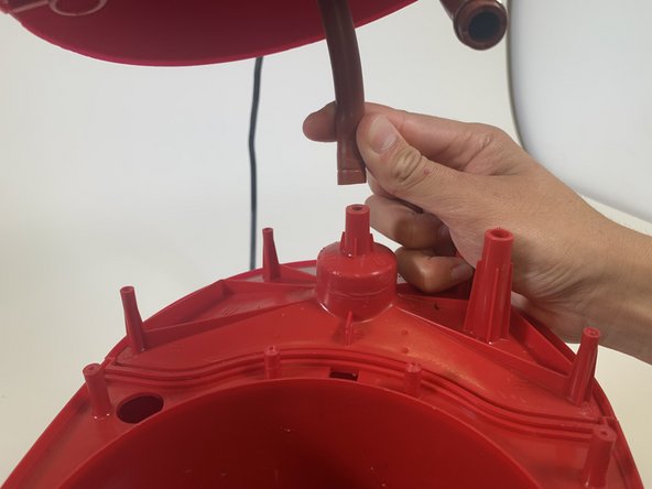

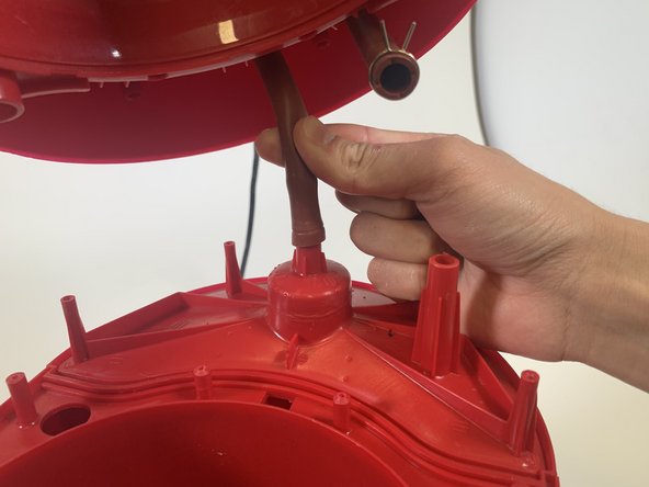

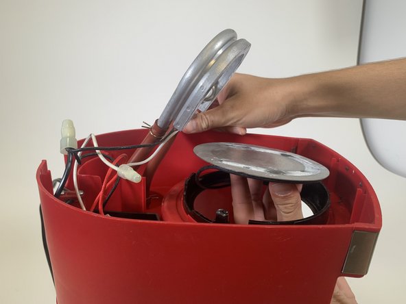

    • Separate the two halves. Use large needle-nose pliers to untwist the wires that secure the heating tubes. Then use a moderate amount of force to pluck the tubes off the spokes.

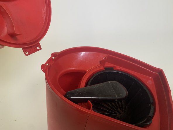

    • Once the two parts are fully separated, take the top element of the machine, and flip it right side up.
    • Remove the coffee maker’s lid by rotating it 180 degrees and gently popping it off of the hinge.

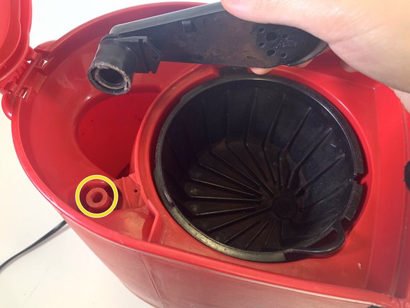

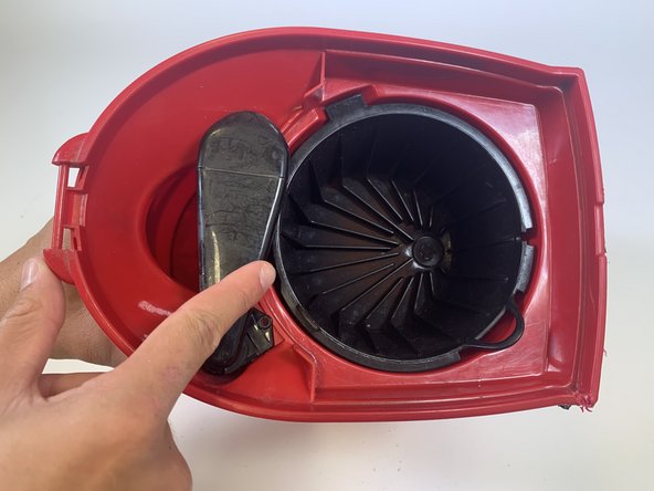

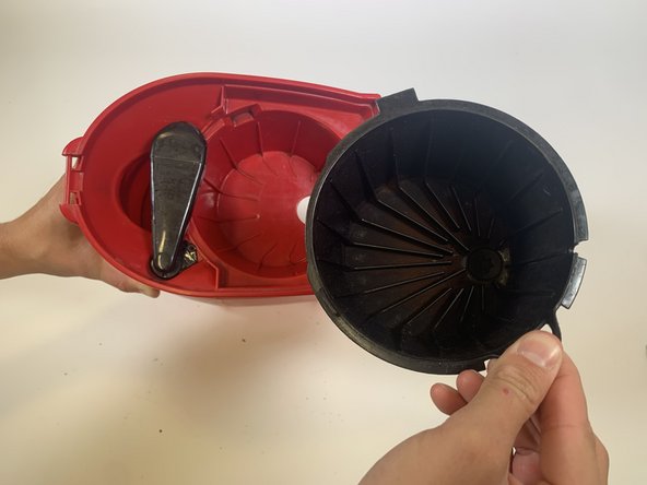

    • Rotate the spout to the back of the machine and take the coffee ground cup out.
  8. Hamilton Beach 43253R Disassembly: crwdns2935265:08crwdnd2935265:01crwdnd2935265:02crwdne2935265:0 Hamilton Beach 43253R Disassembly: crwdns2935265:08crwdnd2935265:02crwdnd2935265:02crwdne2935265:0
    • Remove the 8 mm Phillips #1 screw that connects the spout to the machine.
    • This will allow access to the hot water tube.

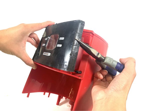

    • Use large needle-nose pliers to pull the secondary cover off.
    • This will deform and crack the plastic as you will need to be forceful.
