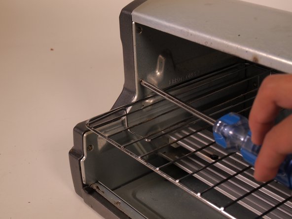

    • Tilt the door into the open position and pull straight up and away from the rest of the oven.
    • It may take some wiggling in a side to side motion to remove the door, but it is not affixed to the oven with fasteners.

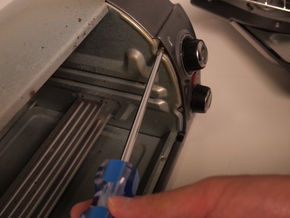

    • Remove the three countersunk, 9 mm Phillips head screws along the dark grey curve.
    • Remove the three Phillips screws on the inside edge of the oven, as shown.

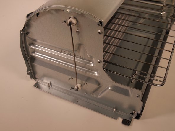

    • Remove the side panel by pulling gently away from the oven.
    • One side of the heating elements can be seen on this side of the oven. The two elements are connected in series with each other so operate simultaneously, and are 6.5 ohms each.
