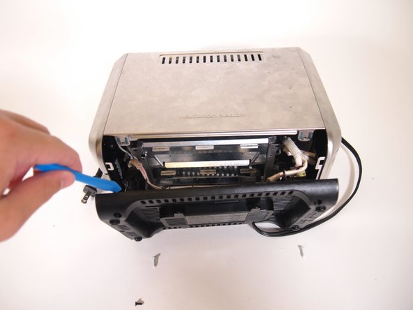

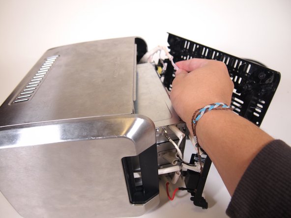

  3. Hamilton Beach 22794 Disassembly: crwdns2935265:03crwdnd2935265:01crwdnd2935265:03crwdne2935265:0 Hamilton Beach 22794 Disassembly: crwdns2935265:03crwdnd2935265:02crwdnd2935265:03crwdne2935265:0 Hamilton Beach 22794 Disassembly: crwdns2935265:03crwdnd2935265:03crwdnd2935265:03crwdne2935265:0

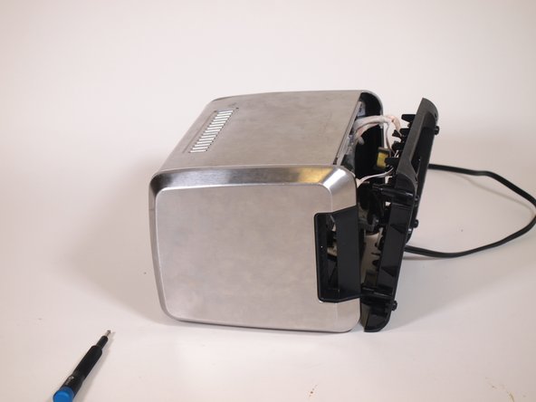

    • Remove the bottom housing of the toaster.
    • This may require a small plastic spudger if it's not easily coming apart.

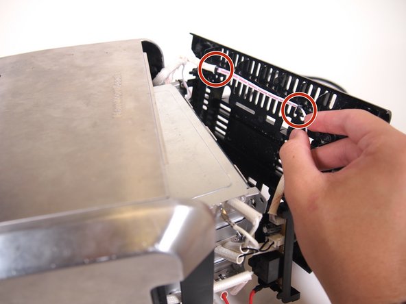

  4. Hamilton Beach 22794 Disassembly: crwdns2935265:04crwdnd2935265:01crwdnd2935265:03crwdne2935265:0 Hamilton Beach 22794 Disassembly: crwdns2935265:04crwdnd2935265:02crwdnd2935265:03crwdne2935265:0 Hamilton Beach 22794 Disassembly: crwdns2935265:04crwdnd2935265:03crwdnd2935265:03crwdne2935265:0
    • As you're removing the bottom, make sure to move any brackets out of the way and unclip the white cable.
    • Pull the cable firmly up & out to free it from the clips.

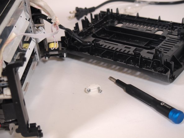

  5. Hamilton Beach 22794 Disassembly: crwdns2935265:05crwdnd2935265:01crwdnd2935265:02crwdne2935265:0 Hamilton Beach 22794 Disassembly: crwdns2935265:05crwdnd2935265:02crwdnd2935265:02crwdne2935265:0
    • Gently lay the bottom housing down and unscrew the 10 mm screws securing the small white bracket with a Phillips #0 screwdriver.

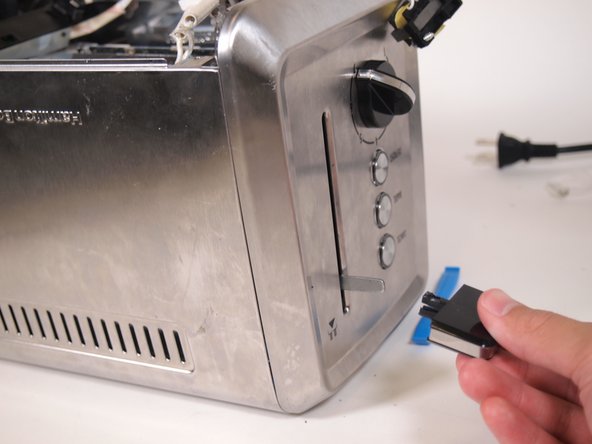

    • Go to the front of the toaster to remove the large square handle.
    • This requires a firm tug and possibly a slight twist to free it from the metal rod.

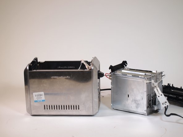

  7. Hamilton Beach 22794 Disassembly: crwdns2935265:07crwdnd2935265:01crwdnd2935265:02crwdne2935265:0 Hamilton Beach 22794 Disassembly: crwdns2935265:07crwdnd2935265:02crwdnd2935265:02crwdne2935265:0
    • Now that the bottom housing and the handle are removed, you can pull up on the central unit and remove it from the top housing.
    • You may need to wiggle this unit to free it from any snagging/catching.

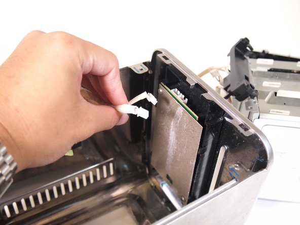

    • After removal, you will see two small wires plugged in to a board.
    • Firmly pull up on these wires to unplug.

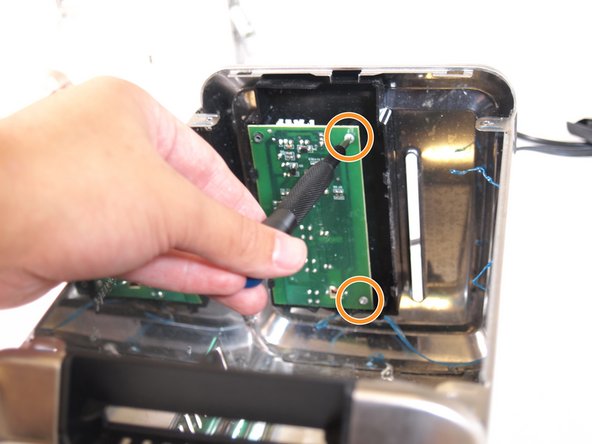

  9. Hamilton Beach 22794 Disassembly: crwdns2935265:09crwdnd2935265:01crwdnd2935265:03crwdne2935265:0 Hamilton Beach 22794 Disassembly: crwdns2935265:09crwdnd2935265:02crwdnd2935265:03crwdne2935265:0 Hamilton Beach 22794 Disassembly: crwdns2935265:09crwdnd2935265:03crwdnd2935265:03crwdne2935265:0
    • Unscrew the two Phillips #0 7 mm screws that secure the metal backing to the circuit board.
    • Remove the metal backing.
    • Unscrew the two 5 mm Phillips #0 screws and remove the board.

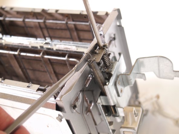

  10. Hamilton Beach 22794 Disassembly: crwdns2935265:010crwdnd2935265:01crwdnd2935265:03crwdne2935265:0 Hamilton Beach 22794 Disassembly: crwdns2935265:010crwdnd2935265:02crwdnd2935265:03crwdne2935265:0 Hamilton Beach 22794 Disassembly: crwdns2935265:010crwdnd2935265:03crwdnd2935265:03crwdne2935265:0

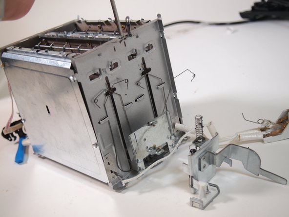

    • Using your metal spudger, unfold the metal bracket and unhook the spring so that you can free the press-down mechanism.
  11. Hamilton Beach 22794 Disassembly: crwdns2935265:011crwdnd2935265:01crwdnd2935265:02crwdne2935265:0 Hamilton Beach 22794 Disassembly: crwdns2935265:011crwdnd2935265:02crwdnd2935265:02crwdne2935265:0
    • Unhook the other springs on the size and pull up on the metal rod to free the push-down mechanism from the center part.
  12. Hamilton Beach 22794 Disassembly: crwdns2935265:012crwdnd2935265:01crwdnd2935265:02crwdne2935265:0 Hamilton Beach 22794 Disassembly: crwdns2935265:012crwdnd2935265:02crwdnd2935265:02crwdne2935265:0

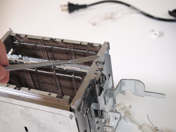

    • Using your metal spudger, unfold the metal tabs holding the bread-holding trays in place.
    • Pulling up, remove the bread-holding metal trays.
