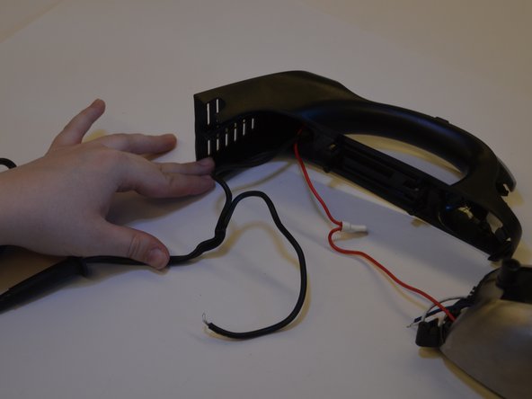

    1. Hamilton Beach  Power Cord Replacement, Power Cord: crwdns2935265:012crwdnd2935265:01crwdnd2935265:03crwdne2935265:0 Hamilton Beach  Power Cord Replacement, Power Cord: crwdns2935265:012crwdnd2935265:02crwdnd2935265:03crwdne2935265:0 Hamilton Beach  Power Cord Replacement, Power Cord: crwdns2935265:012crwdnd2935265:03crwdnd2935265:03crwdne2935265:0
      • Liftback end of the handle up from motor casing.
      • Pull back to detach fully from the stainless steel.
    2. Hamilton Beach  Power Cord Replacement: crwdns2935265:013crwdnd2935265:01crwdnd2935265:03crwdne2935265:0 Hamilton Beach  Power Cord Replacement: crwdns2935265:013crwdnd2935265:02crwdnd2935265:03crwdne2935265:0 Hamilton Beach  Power Cord Replacement: crwdns2935265:013crwdnd2935265:03crwdnd2935265:03crwdne2935265:0
      • Remove the three 7.8 mm Philips #2 screws holding the power cord in place.

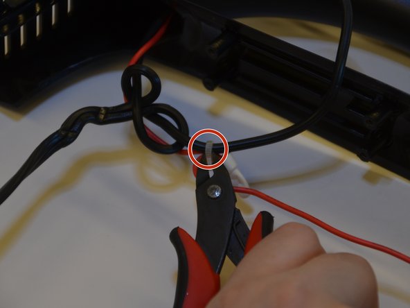

    3. Hamilton Beach  Power Cord Replacement: crwdns2935265:014crwdnd2935265:01crwdnd2935265:03crwdne2935265:0 Hamilton Beach  Power Cord Replacement: crwdns2935265:014crwdnd2935265:02crwdnd2935265:03crwdne2935265:0 Hamilton Beach  Power Cord Replacement: crwdns2935265:014crwdnd2935265:03crwdnd2935265:03crwdne2935265:0
      • Cut zip tie holding the power cable together using handheld wire cutters.

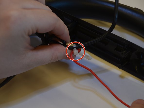

    4. Hamilton Beach  Power Cord Replacement: crwdns2935265:015crwdnd2935265:01crwdnd2935265:03crwdne2935265:0 Hamilton Beach  Power Cord Replacement: crwdns2935265:015crwdnd2935265:02crwdnd2935265:03crwdne2935265:0 Hamilton Beach  Power Cord Replacement: crwdns2935265:015crwdnd2935265:03crwdnd2935265:03crwdne2935265:0
      • Untie the black lead's knot.
      • Cut both wires with handheld wire cutters.
      • Follow this guide to solder new power cord wires in.
