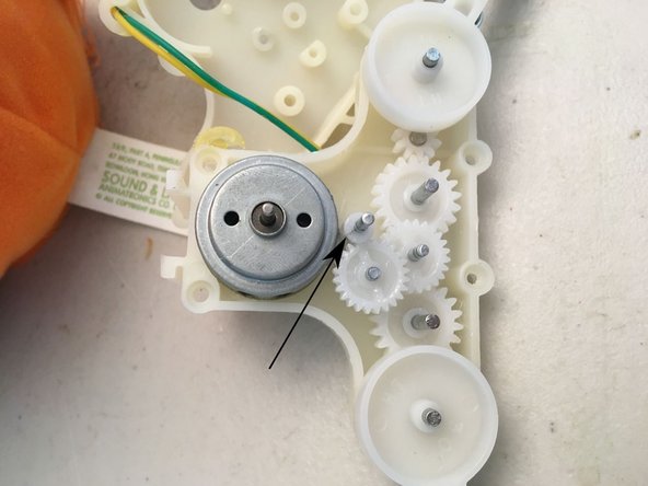

Halloween Witch Doctor Dancing Dog Broken Gear Replacement
  1. Halloween Witch Doctor Dancing Dog Broken Gear Replacement, Remove blind stitch to access mechanism.: crwdns2935265:01crwdnd2935265:01crwdnd2935265:01crwdne2935265:0
    • The bottom plate is removable, but doesn't give you access to the mechanism.
    • Blind stitch looks different from other seams in fabric.
  2. Halloween Witch Doctor Dancing Dog Broken Gear Replacement, Remove ear mechanism: crwdns2935265:02crwdnd2935265:01crwdnd2935265:02crwdne2935265:0 Halloween Witch Doctor Dancing Dog Broken Gear Replacement, Remove ear mechanism: crwdns2935265:02crwdnd2935265:02crwdnd2935265:02crwdne2935265:0
    • If you look closely at gear, you can see a small crack
    • I bought an assortment of plastic gears from Amazon because I wasn't sure of the size. https://www.amazon.com/gp/product/B075QY...
    • I ending up using an 8 tooth, 2mm shaft, 0.5 modulus gear. That is, an 82A white plastic gear.
Here is a video of it working again!
https://www.youtube.com/shorts/AESLgu-wI...
