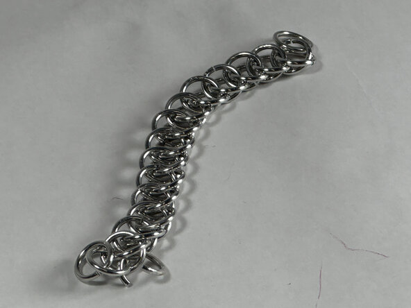

    • Locate the broken link within the Half Persian 3-in-1 chainmail pattern.
    • Half Persian 3-in-1 can be split into two main chains: the front part and the back part.
    • Laying it flat can help you spot where the link has broke.

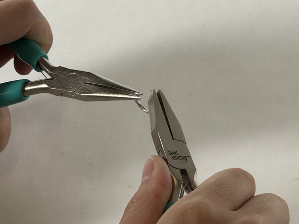

    • Take a new jump ring and pry it open with your pliers.

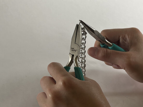

    • Insert the ring in the gap identified from Step 1.
    • Generally, the jump ring should be going through 3 different jump rings.
    • Compare your chainmail to the previous links to see if your new connection matches the pattern.

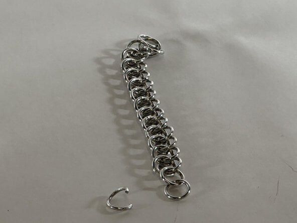

    • Close the newly linked jump ring with your pliers.

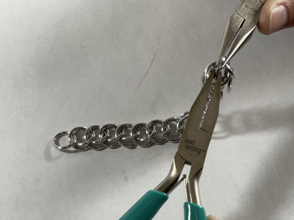

    • Lay your chainmail flat to inspect for any other broken links, and repeat steps 1-4 until all links are fixed.
    • A fully fixed Half Persian 3-in-1 chainmail piece will look like the image attached. Compare your final product with the image to see if any links are missing.
