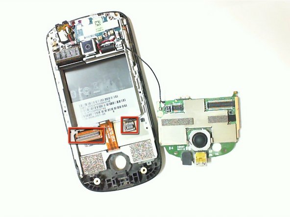

      • Lift up the circuit board gently from the right. You will notice some resistance due to the two ribbon cables attached underneath the circuit board. Continue to lift gently on the right until the ribbons detach and the resistance is released.
      • Proceed carefully with this step so that the cables are released without damage.
