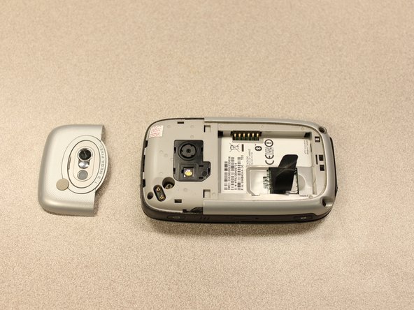

    • To expose the battery, remove the outer case with your fingernail.
    • Remove the battery by pulling the black tab.
  2. HTC Wizard 200 Speakers Replacement, Back Panel: crwdns2935265:02crwdnd2935265:01crwdnd2935265:01crwdne2935265:0
    Spudger
    $3.99
    • Insert the flat end of the spudger into the two notches on the back of the camera cover and pry them up.
  3. HTC Wizard 200 Speakers Replacement: crwdns2935265:03crwdnd2935265:01crwdnd2935265:02crwdne2935265:0 HTC Wizard 200 Speakers Replacement: crwdns2935265:03crwdnd2935265:02crwdnd2935265:02crwdne2935265:0
    Spudger
    $3.99
    • Work the spudger around the edges of the camera cover until it comes off.

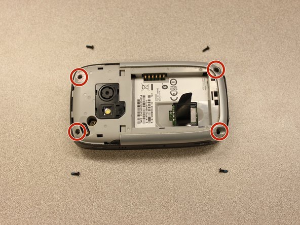

  4. HTC Wizard 200 Speakers Replacement: crwdns2935265:04crwdnd2935265:01crwdnd2935265:02crwdne2935265:0 HTC Wizard 200 Speakers Replacement: crwdns2935265:04crwdnd2935265:02crwdnd2935265:02crwdne2935265:0
    T5 Torx Screwdriver
    $5.49
    • Remove the four 6 mm screws with the T5 Torx screwdriver.
    • One of the screws is under the "void" sticker.

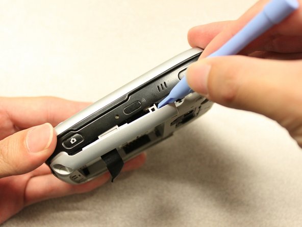

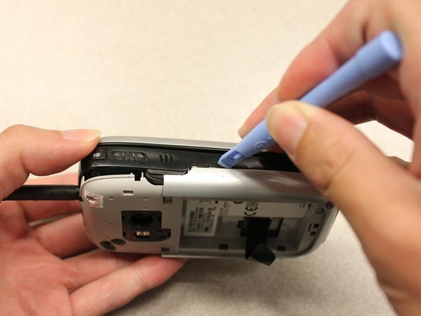

  5. HTC Wizard 200 Speakers Replacement: crwdns2935265:05crwdnd2935265:01crwdnd2935265:03crwdne2935265:0 HTC Wizard 200 Speakers Replacement: crwdns2935265:05crwdnd2935265:02crwdnd2935265:03crwdne2935265:0 HTC Wizard 200 Speakers Replacement: crwdns2935265:05crwdnd2935265:03crwdnd2935265:03crwdne2935265:0
    • Insert the flat end of an iFixit opening tool between the side and inner covers to create a gap.
    • Work the tool around the edges until all the clips release.

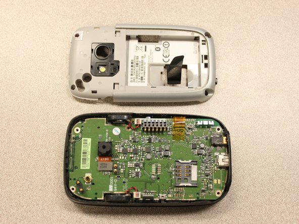

  6. HTC Wizard 200 Speakers Replacement: crwdns2935265:06crwdnd2935265:01crwdnd2935265:02crwdne2935265:0 HTC Wizard 200 Speakers Replacement: crwdns2935265:06crwdnd2935265:02crwdnd2935265:02crwdne2935265:0
    • Once all the clips are open, remove the inner panel from the phone.

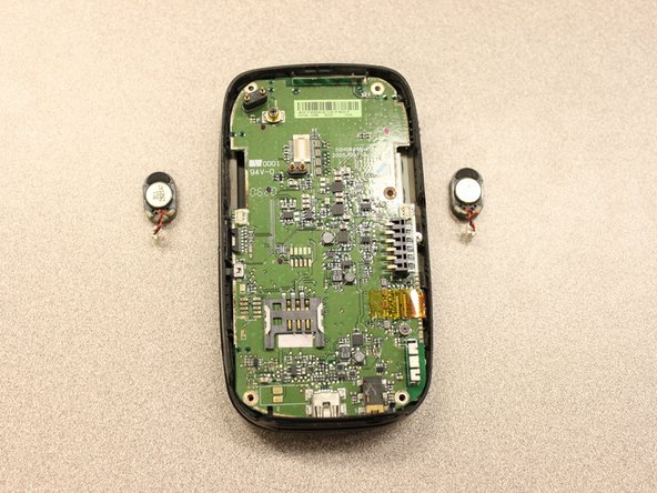

  7. HTC Wizard 200 Speakers Replacement, Speakers: crwdns2935265:07crwdnd2935265:01crwdnd2935265:02crwdne2935265:0 HTC Wizard 200 Speakers Replacement, Speakers: crwdns2935265:07crwdnd2935265:02crwdnd2935265:02crwdne2935265:0
    • Device rotated 180 degrees.
    • Use the plastic opening tool to disconnect the speaker connections.
