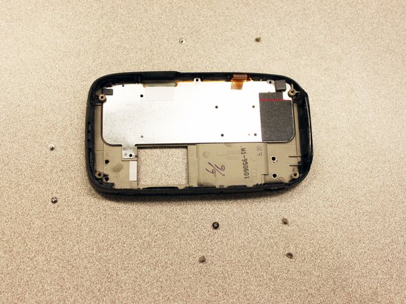

    1. HTC Wizard 200 Keypad Replacement, Keyboard Slider: crwdns2935265:012crwdnd2935265:01crwdnd2935265:03crwdne2935265:0 HTC Wizard 200 Keypad Replacement, Keyboard Slider: crwdns2935265:012crwdnd2935265:02crwdnd2935265:03crwdne2935265:0 HTC Wizard 200 Keypad Replacement, Keyboard Slider: crwdns2935265:012crwdnd2935265:03crwdnd2935265:03crwdne2935265:0
      T5 Torx Screwdriver
      $5.49
      • Remove the four 5mm screws with the T5 Torx screwdriver.
      • Remove the keyboard slider from the main body.

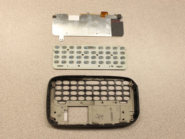

    1. HTC Wizard 200 Keypad Replacement, Keypad: crwdns2935265:013crwdnd2935265:01crwdnd2935265:02crwdne2935265:0 HTC Wizard 200 Keypad Replacement, Keypad: crwdns2935265:013crwdnd2935265:02crwdnd2935265:02crwdne2935265:0
      • Use a screwdriver to remove eight 2mm Phillips screws that secure the keypad to the keyboard slider.
    2. HTC Wizard 200 Keypad Replacement: crwdns2935265:014crwdnd2935265:01crwdnd2935265:02crwdne2935265:0 HTC Wizard 200 Keypad Replacement: crwdns2935265:014crwdnd2935265:02crwdnd2935265:02crwdne2935265:0
      • Use the plastic opening tool to gently lift up the keypad.
