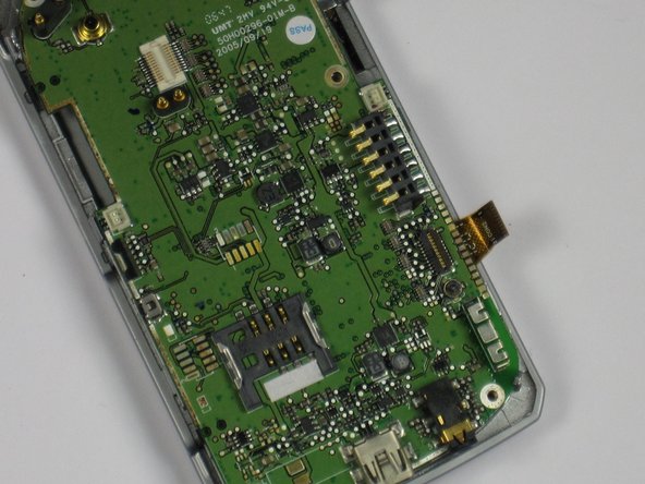

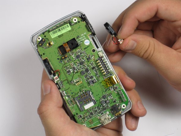

    1. HTC Wizard 100 Screen Replacement, Motherboard: crwdns2935265:08crwdnd2935265:01crwdnd2935265:01crwdne2935265:0
      • Remove the 3.4 mm black screw with the Phillips #000 screwdriver.
    2. HTC Wizard 100 Screen Replacement: crwdns2935265:09crwdnd2935265:01crwdnd2935265:02crwdne2935265:0 HTC Wizard 100 Screen Replacement: crwdns2935265:09crwdnd2935265:02crwdnd2935265:02crwdne2935265:0
      • Remove the plastic tape to reveal the connector.
      • Use your finger or plastic opening tool to flip the connector and release the cable.
    3. HTC Wizard 100 Screen Replacement: crwdns2935265:010crwdnd2935265:01crwdnd2935265:02crwdne2935265:0 HTC Wizard 100 Screen Replacement: crwdns2935265:010crwdnd2935265:02crwdnd2935265:02crwdne2935265:0
      • Use the plastic opening tool to carefully lift the motherboard off one corner at a time.
      • Lift the motherboard slowly away from the keyboard because there is a cable attached to bottom of the motherboard.
      • If the motherboard is not easily removed by pulling, then lift one side of the motherboard until you can see the attached cable. Then use the plastic opening tool to detach the cable from the motherboard.

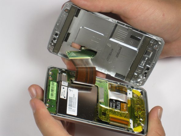

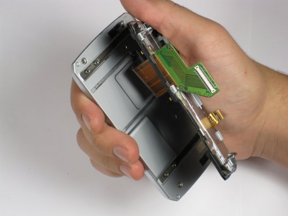

    1. HTC Wizard 100 Screen Replacement, Screen: crwdns2935265:011crwdnd2935265:01crwdnd2935265:02crwdne2935265:0 HTC Wizard 100 Screen Replacement, Screen: crwdns2935265:011crwdnd2935265:02crwdnd2935265:02crwdne2935265:0
      • Using the Phillips Screwdriver #000 remove the four 3.3 mm screws.
      • Carefully lift the keyboard from the plastic plate by allowing the ribbon cable to slip through the opening of the plastic plate.
    2. HTC Wizard 100 Screen Replacement: crwdns2935265:012crwdnd2935265:01crwdnd2935265:01crwdne2935265:0
      • Use the Phillips Screwdriver #000 to remove the four 3.8 mm screws from the back of the screen.
    3. HTC Wizard 100 Screen Replacement: crwdns2935265:013crwdnd2935265:01crwdnd2935265:03crwdne2935265:0 HTC Wizard 100 Screen Replacement: crwdns2935265:013crwdnd2935265:02crwdnd2935265:03crwdne2935265:0 HTC Wizard 100 Screen Replacement: crwdns2935265:013crwdnd2935265:03crwdnd2935265:03crwdne2935265:0

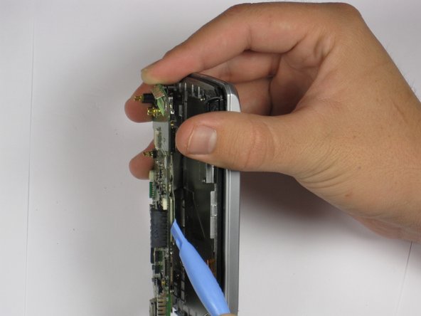

      • Insert the spudger between the panel and the case.
      • Gently pry off the panel by rotating or wiggling the spudger back and forth.
      • Lift the panel off while allowing the ribbon to slip through the opening.

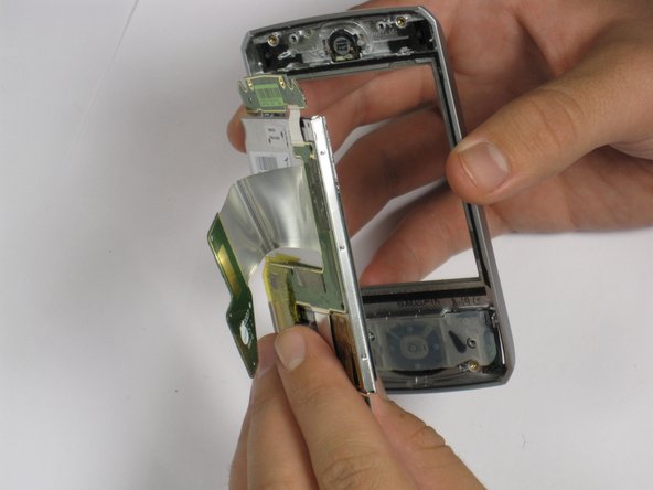

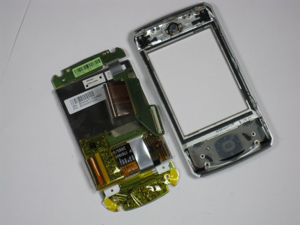

    4. HTC Wizard 100 Screen Replacement: crwdns2935265:014crwdnd2935265:01crwdnd2935265:03crwdne2935265:0 HTC Wizard 100 Screen Replacement: crwdns2935265:014crwdnd2935265:02crwdnd2935265:03crwdne2935265:0 HTC Wizard 100 Screen Replacement: crwdns2935265:014crwdnd2935265:03crwdnd2935265:03crwdne2935265:0
      • Remove the four 2.9 mm screws with the Phillips Screwdriver #000.
      • Use your fingers to separate the screen assembly from the front panel.

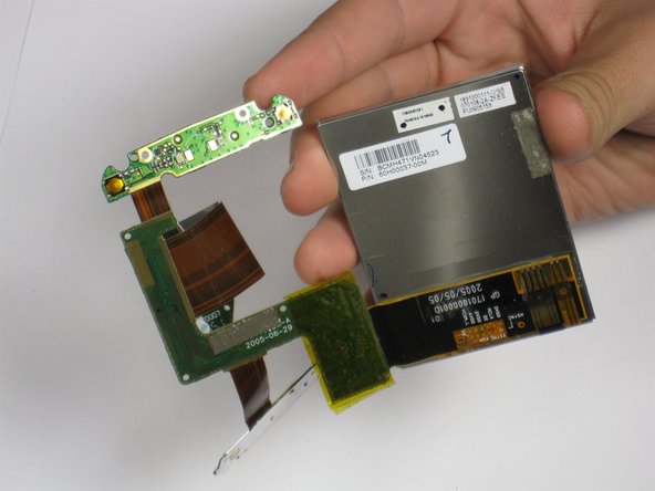

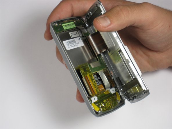

    5. HTC Wizard 100 Screen Replacement: crwdns2935265:015crwdnd2935265:01crwdnd2935265:02crwdne2935265:0 HTC Wizard 100 Screen Replacement: crwdns2935265:015crwdnd2935265:02crwdnd2935265:02crwdne2935265:0
      • Insert the spudger between the green panel and the screen itself.
      • Gently wiggle the spudger to pry them apart.

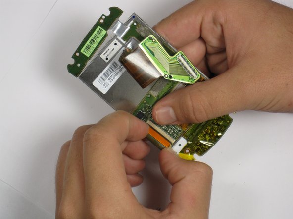

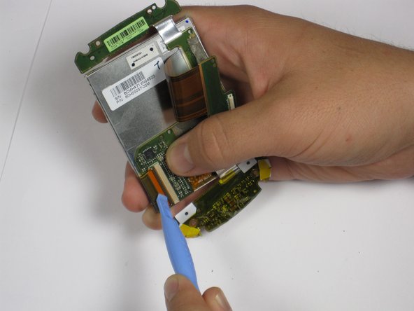

    6. HTC Wizard 100 Screen Replacement: crwdns2935265:016crwdnd2935265:01crwdnd2935265:03crwdne2935265:0 HTC Wizard 100 Screen Replacement: crwdns2935265:016crwdnd2935265:02crwdnd2935265:03crwdne2935265:0 HTC Wizard 100 Screen Replacement: crwdns2935265:016crwdnd2935265:03crwdnd2935265:03crwdne2935265:0
      • Remove the tape.
      • Locate the connecting ribbon.
      • Using the spudger or your thumb and finger, flip the switch up and disconnect the ribbon.
      • Lift off the panel from the screen.
