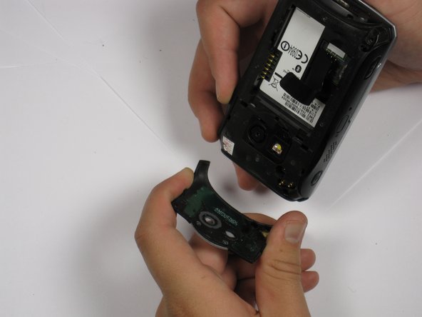

    1. HTC Wizard 100 Camera Replacement, Back Case: crwdns2935265:03crwdnd2935265:01crwdnd2935265:02crwdne2935265:0 HTC Wizard 100 Camera Replacement, Back Case: crwdns2935265:03crwdnd2935265:02crwdnd2935265:02crwdne2935265:0
      • Use a plastic opening tool to remove the camera cover.
      • Work around the corners to avoid breaking the plastic clips that hold the camera cover on.
      • Lift the camera cover off of the phone.

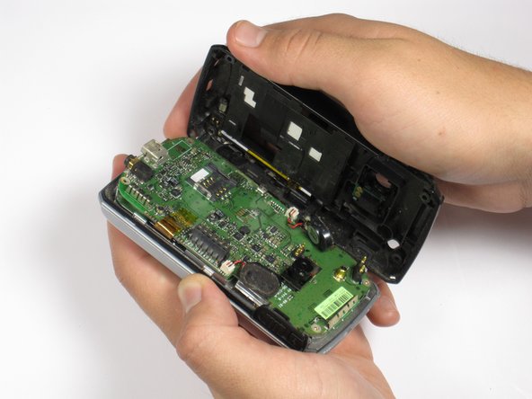

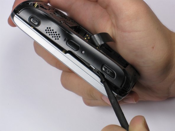

    3. HTC Wizard 100 Camera Replacement: crwdns2935265:05crwdnd2935265:01crwdnd2935265:03crwdne2935265:0 HTC Wizard 100 Camera Replacement: crwdns2935265:05crwdnd2935265:02crwdnd2935265:03crwdne2935265:0 HTC Wizard 100 Camera Replacement: crwdns2935265:05crwdnd2935265:03crwdnd2935265:03crwdne2935265:0
      • Be Careful! Do not insert the spudger in between the keyboard and screen. This could break the keyboard off the phone.
      • If your phone contains a memory card, you may want to remove it before proceeding with this step.
      • Insert spudger in the bottom corner as seen in the picture. Carefully slide the spudger from the bottom towards the top as seen in the second picture.
      • Lift the back case off completely.
      • The speakers might be dangling and unsecured.
