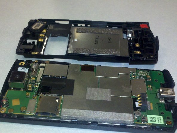

  5. HTC Warhawk Screen Replacement: crwdns2935265:05crwdnd2935265:01crwdnd2935265:02crwdne2935265:0 HTC Warhawk Screen Replacement: crwdns2935265:05crwdnd2935265:02crwdnd2935265:02crwdne2935265:0
    • Take the SL#2.5 screwdriver and pry off the back cover
    • The phone should now look like the second picture

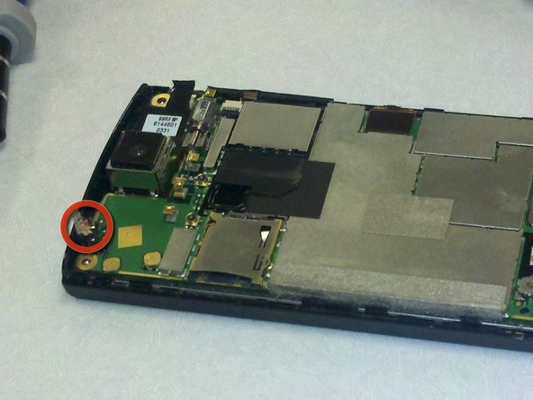

  6. HTC Warhawk Screen Replacement: crwdns2935265:06crwdnd2935265:01crwdnd2935265:02crwdne2935265:0 HTC Warhawk Screen Replacement: crwdns2935265:06crwdnd2935265:02crwdnd2935265:02crwdne2935265:0
    • Next lift up the camera lens from the board.
    • Then pry off the circuit circled in red on the second picture

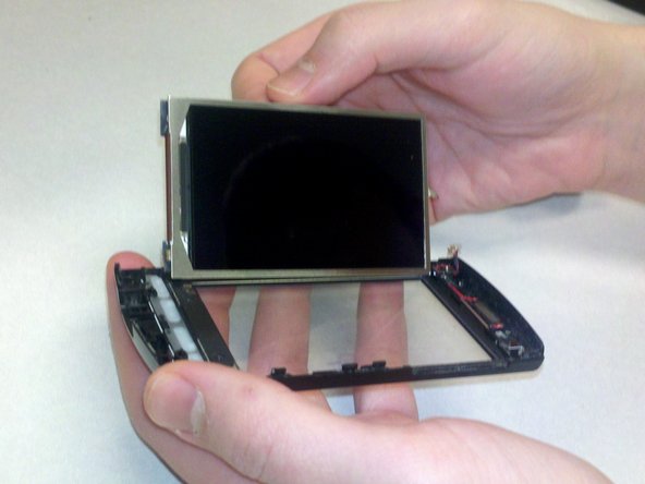

  9. HTC Warhawk Screen Replacement: crwdns2935265:09crwdnd2935265:01crwdnd2935265:02crwdne2935265:0 HTC Warhawk Screen Replacement: crwdns2935265:09crwdnd2935265:02crwdnd2935265:02crwdne2935265:0
    • Next take the SL#2.5 screwdriver and pry the screen from the front plastic cover
    • The screen should come out with ease and be completely detached from the rest of the cover.
    • Replace screen with a new one.
