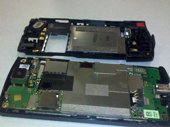

  5. HTC Warhawk Buttons Replacement: crwdns2935265:05crwdnd2935265:01crwdnd2935265:02crwdne2935265:0 HTC Warhawk Buttons Replacement: crwdns2935265:05crwdnd2935265:02crwdnd2935265:02crwdne2935265:0
    • Take the SL#2.5 screwdriver and pry off the back cover
    • The phone should now look like the second picture

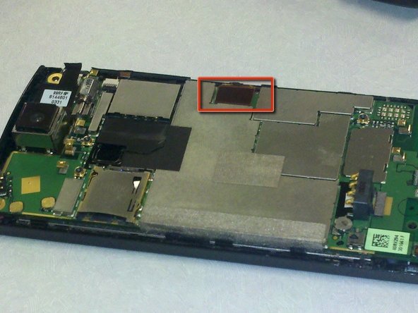

  7. HTC Warhawk Buttons Replacement: crwdns2935265:07crwdnd2935265:01crwdnd2935265:02crwdne2935265:0 HTC Warhawk Buttons Replacement: crwdns2935265:07crwdnd2935265:02crwdnd2935265:02crwdne2935265:0
    • Next lift up the camera lens from the board.
    • It should now look like the second picture
    • Then lift up the circuit circled in red on the second picture

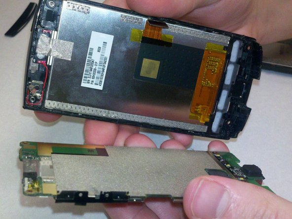

  8. HTC Warhawk Buttons Replacement: crwdns2935265:08crwdnd2935265:01crwdnd2935265:02crwdne2935265:0 HTC Warhawk Buttons Replacement: crwdns2935265:08crwdnd2935265:02crwdnd2935265:02crwdne2935265:0
    • Take the SL#2.5 screwdriver and pry off the volume buttons on the side of the phone
    • The circuit board should now be detached from the LCD part of the phone
