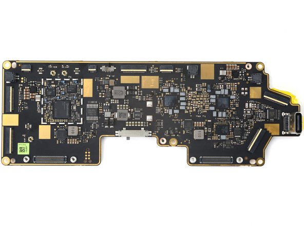

  1. HTC Vive XR Elite Chip ID, Headset Mainboard Side A: crwdns2935265:01crwdnd2935265:01crwdnd2935265:02crwdne2935265:0 HTC Vive XR Elite Chip ID, Headset Mainboard Side A: crwdns2935265:01crwdnd2935265:02crwdnd2935265:02crwdne2935265:0
    • Samsung K3UHAHA0BM-AGCL 12 GB LPDDR4X SDRAM memory layered above a Qualcomm Snapdragon XR2 applications processor
    • Samsung KLUDG4UHGC-B0E1 128 GB UFS 3.1 NAND flash memory
    • Qualcomm PM8009-100 power management
    • Qualcomm PM3003A ? power management
    • Qualcomm PMK8002 ? clock generator
    • onsemi FSA3000L10X 2-port USB 2.0 MHL switch
    • onsemi FSA550 4PST analog switch
  2. HTC Vive XR Elite Chip ID: crwdns2935265:02crwdnd2935265:01crwdnd2935265:01crwdne2935265:0
    • Silergy SY7069ADC 3 A synchronous boost converter
    • Texas Instruments TPS62135 4 A step-down converter
    • Global Mixed-mode Technology G2264A 3 A synchronous step-down converter
    • Kinetic Technologies KTS1676EUT overvoltage protectior
    • Texas Instruments TLV9064IRUCR quad operational amplifier
    • Awinic AW37030D280DNR 300 mA / 2.8 V LDO regulator
  3. HTC Vive XR Elite Chip ID, Headset Mainboard Side A - Connectivity: crwdns2935265:03crwdnd2935265:01crwdnd2935265:01crwdne2935265:0
    • Nordic Semiconductor nRF52832 Bluetooth 5.2 SoC
  4. HTC Vive XR Elite Chip ID, Headset Mainboard Side B: crwdns2935265:04crwdnd2935265:01crwdnd2935265:02crwdne2935265:0 HTC Vive XR Elite Chip ID, Headset Mainboard Side B: crwdns2935265:04crwdnd2935265:02crwdnd2935265:02crwdne2935265:0
    • Qualcomm PM8150B-102 power management
    • Qualcomm PM8150L-103 power management
    • Qualcomm PM8250-003 power management
    • Qualcomm WSA8810-0VV 2 W class-D audio amplfier
    • Texas Instruments LP8556SQ-E09 6-ch. LED backlight driver
    • VIA Labs VL163 10-Gbps USB type-C data switch
    • Analog Devices MAX31760 fan controller
  5. HTC Vive XR Elite Chip ID: crwdns2935265:05crwdnd2935265:01crwdnd2935265:01crwdne2935265:0
    • Silergy SY7120RAC 10 A / 16 V synchronous boost converter
    • Texas Instruments LM358TP dual 1-MHz operational amplifier
  6. HTC Vive XR Elite Chip ID, Headset Mainboard Side B - Connectivity: crwdns2935265:06crwdnd2935265:01crwdnd2935265:01crwdne2935265:0
    • Qualcomm WCN6851-102 FastConnect 6900 WiFi 6, 6E, & Bluetooth 5.3 controller
    • Qorvo QM42391 2.4 GHz WLAN Front-End Module
    • Qorvo QM45392 5-7.2 GHz WLAN Front-End Module

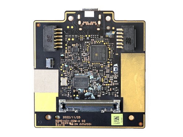

  7. HTC Vive XR Elite Chip ID, Battery Board Side A: crwdns2935265:07crwdnd2935265:01crwdnd2935265:02crwdne2935265:0 HTC Vive XR Elite Chip ID, Battery Board Side A: crwdns2935265:07crwdnd2935265:02crwdnd2935265:02crwdne2935265:0
    • STMicroelectronics STM32L412CB 32-bit ARM Cortex-M4 microcontroller w/ 1 Mb flash
    • Kinetic Technologies MCDP6200C1 USB Type-C switching retimer
    • onsemi FUSB302TMPX USB Type-C controller w/ power delivery
    • onsemi FSUSB30UMX 2-port, 480 Mbps USB 2.0 analog switch
    • Texas Instruments TUSB212 USB 2.0 signal conditioner

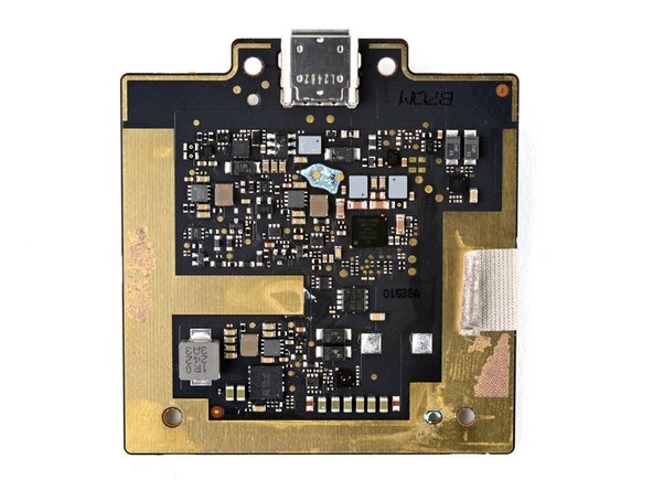

  8. HTC Vive XR Elite Chip ID, Battery Board Side B: crwdns2935265:08crwdnd2935265:01crwdnd2935265:02crwdne2935265:0 HTC Vive XR Elite Chip ID, Battery Board Side B: crwdns2935265:08crwdnd2935265:02crwdnd2935265:02crwdne2935265:0
    • Qualcomm SMB1380-000 single-cell Li-ion battery charger w/ Quick Charge 3.0 support
    • Silergy DC-DC converter
    • Kinetic Technologies KTS1693EVB load switch w/ over-voltage & over-current protection
    • Kinetic Technologies KTS1668EAY 4 A over-voltage protection
