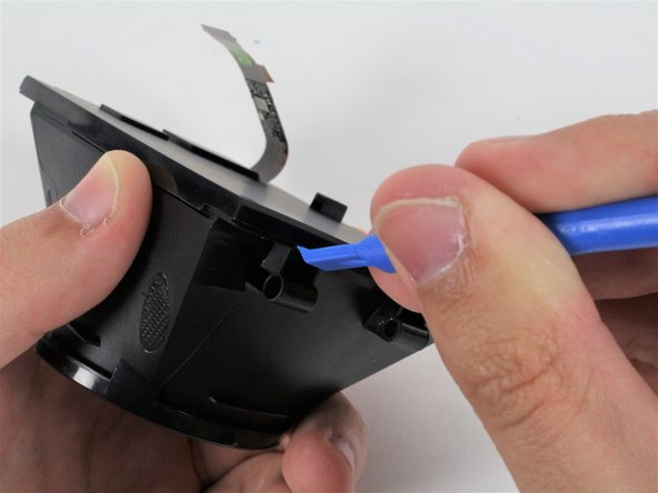

    7. HTC Vive OLED Screen Replacement, Remove the OLED covers: crwdns2935265:038crwdnd2935265:01crwdnd2935265:02crwdne2935265:0 HTC Vive OLED Screen Replacement, Remove the OLED covers: crwdns2935265:038crwdnd2935265:02crwdnd2935265:02crwdne2935265:0
      • Use the flat end of a spudger push up one edge of the OLED cover and start unclipping that edge.
    8. HTC Vive OLED Screen Replacement: crwdns2935265:039crwdnd2935265:01crwdnd2935265:02crwdne2935265:0 HTC Vive OLED Screen Replacement: crwdns2935265:039crwdnd2935265:02crwdnd2935265:02crwdne2935265:0
      • Slide the spudger under the clip along that edge to free the rest of the edge.
    9. HTC Vive OLED Screen Replacement: crwdns2935265:040crwdnd2935265:01crwdnd2935265:03crwdne2935265:0 HTC Vive OLED Screen Replacement: crwdns2935265:040crwdnd2935265:02crwdnd2935265:03crwdne2935265:0 HTC Vive OLED Screen Replacement: crwdns2935265:040crwdnd2935265:03crwdnd2935265:03crwdne2935265:0
      • Slide the spudger around the remaining edges of the OLED cover to unclip those edges.

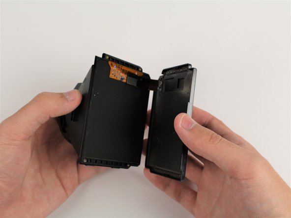

    11. HTC Vive OLED Screen Replacement, Remove the OLED displays: crwdns2935265:042crwdnd2935265:01crwdnd2935265:01crwdne2935265:0
      • Very carefully lift the OLED display by its edges out of its frame.
      • If you are reusing the OLED displays, be very careful to avoid touching the front of the displays or bending or cracking the displays.
      • Repeat this process for the other OLED display.

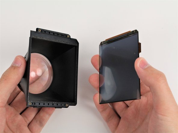

    1. HTC Vive OLED Screen Replacement, OLED Screen: crwdns2935265:046crwdnd2935265:01crwdnd2935265:01crwdne2935265:0
      • The screws are very close to the screen. Applying too much pressure to the screws can stress or crack the screen. Be careful when unscrewing and screwing around the screen.
      • Remove the four 2mm #00 Philips head screws holding the screen in place from the eyepiece assembly.
    2. HTC Vive OLED Screen Replacement: crwdns2935265:047crwdnd2935265:01crwdnd2935265:03crwdne2935265:0 HTC Vive OLED Screen Replacement: crwdns2935265:047crwdnd2935265:02crwdnd2935265:03crwdne2935265:0 HTC Vive OLED Screen Replacement: crwdns2935265:047crwdnd2935265:03crwdnd2935265:03crwdne2935265:0
      • Use a plastic opening tool to gently pry around the seam between the eyepiece housing and the screen.
      • Gently pull the screen cover away from the eyepiece housing, threading the ribbon cable through the hole.
    3. HTC Vive OLED Screen Replacement: crwdns2935265:048crwdnd2935265:01crwdnd2935265:02crwdne2935265:0 HTC Vive OLED Screen Replacement: crwdns2935265:048crwdnd2935265:02crwdnd2935265:02crwdne2935265:0
      • Remove the screen from the eyepiece housing by pulling the two pieces away from each other.
