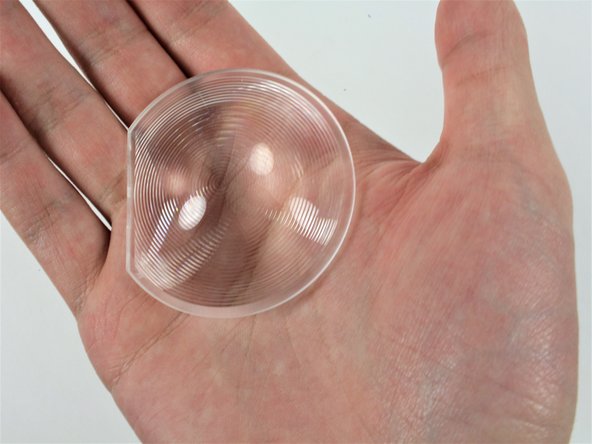

  43. HTC Vive Lens Replacement, Remove the lenses: crwdns2935265:043crwdnd2935265:01crwdnd2935265:01crwdne2935265:0
    • Apply an iOpener to the lens to soften the adhesive securing it to the frame.
  44. HTC Vive Lens Replacement: crwdns2935265:044crwdnd2935265:01crwdnd2935265:02crwdne2935265:0 HTC Vive Lens Replacement: crwdns2935265:044crwdnd2935265:02crwdnd2935265:02crwdne2935265:0
    • Use an opening tool to pry up the flat edge of the lens.
    • If it's difficult to pry up, apply the iOpener for another 30 seconds to further soften the adhesive.
  45. HTC Vive Lens Replacement, Remove the lens: crwdns2935265:045crwdnd2935265:01crwdnd2935265:01crwdne2935265:0
    • Remove the lens.
    • Repeat the last two steps to remove the other lens.
    • Only the lens and OLED frames remain.
    • During reassembly, make sure the convex side of the lens is facing away from the frame.

    • Hold your hand in front of the lens and be ready to catch the lens during its removal.
    • From the inside of the black plastic housing, push gently around the edges of the lens to remove it.
    • Glue holds the lens in place; pushing around the edges will gradually loosen and break the bond. After breaking the bond, the lens will fall forward.

Or… you can simply use an exacto knife and pry the lenses out without taking the entire HMD apart!
You can insert a scalpel type knife between the lens and the housing and work your way around.
techy76 - crwdns2934203:0crwdne2934203:0
I’ve got to agree . This is the absolute worst way to do what’s essentially a simple operation. So many ways this could go wrong for the user if they’re not careful.
This reeks of click bait re-purposing of the tear-down coverage.
Ian Kennedy -
This has to be the most overly complicated approach for a VERY simple fix. Takes about 5 seconds to pop out the lenses by carefully prying at the flat edge with a butter knife, exacto knife, etc.
Brian Lovett - crwdns2934203:0crwdne2934203:0
Agreed! what rubbish…
Lionel Van Niekerk -
We are showing you the most technical and professional way to take out the lens. Remember this is just a guide. You can use whichever way you most comfortable to take apart your HTC.
