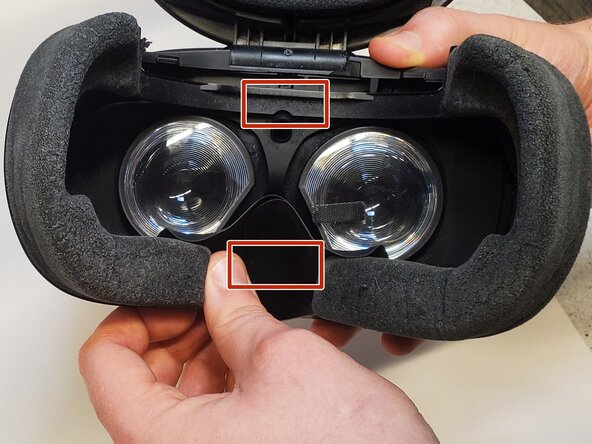

  1. HTC Vive Cosmos Disassembly, Remove Faceplate: crwdns2935265:01crwdnd2935265:01crwdnd2935265:01crwdne2935265:0
    • pull from the nose and top middle to remove the face plate

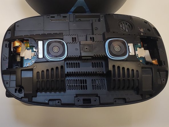

  8. HTC Vive Cosmos Disassembly, Remove Camera Plate: crwdns2935265:08crwdnd2935265:01crwdnd2935265:01crwdne2935265:0
    • Insert card between camera plate and the headset to separate.
    • May use card or other soft flat surfaces like a spudger.

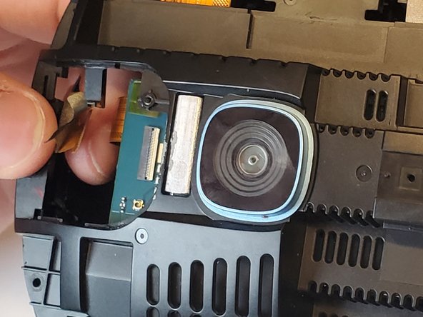

  10. HTC Vive Cosmos Disassembly, Unplug Jumper Cables: crwdns2935265:010crwdnd2935265:01crwdnd2935265:02crwdne2935265:0 HTC Vive Cosmos Disassembly, Unplug Jumper Cables: crwdns2935265:010crwdnd2935265:02crwdnd2935265:02crwdne2935265:0
    • Static Warning for circuit board interaction. When dealing with jumper cables and circuit boards touch metal not located on Vive for 15 seconds before removing component. Keep in mind for remaining steps.
    • Unplug the jumper cables from the circuit boards to detach.

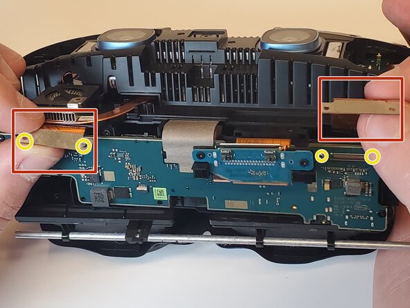

  11. HTC Vive Cosmos Disassembly, Detach Jumper Cables: crwdns2935265:011crwdnd2935265:01crwdnd2935265:01crwdne2935265:0
    • Unscrew the four silver Torx screws on the jumper cables using the T5 driver.
    • Keep note of the four silver Torx screws which are different than the other screws.
    • Pull the jumper cables away from the holding and remove.

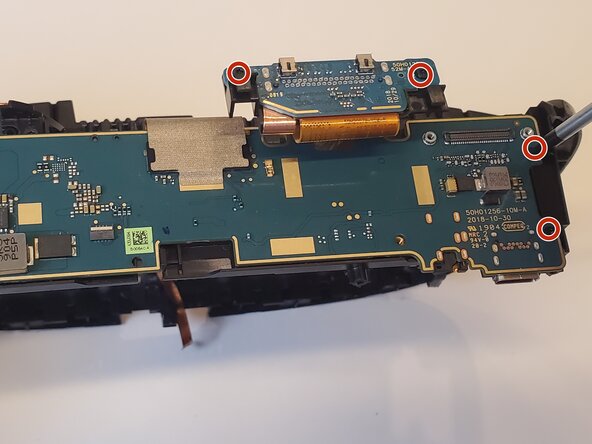

  12. HTC Vive Cosmos Disassembly, Remove Cable Port Board Screws: crwdns2935265:012crwdnd2935265:01crwdnd2935265:01crwdne2935265:0
    • Unscrew the five black Torx screws using the T5 driver on the circuit board.[two more off the left of the image]

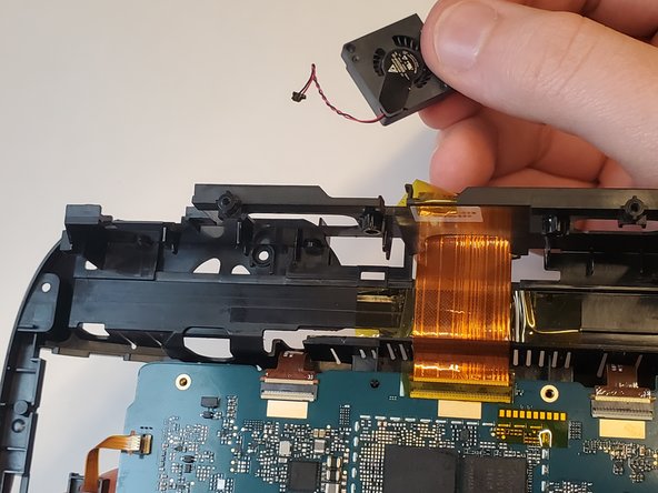

  15. HTC Vive Cosmos Disassembly, Remove Fan Screws: crwdns2935265:015crwdnd2935265:01crwdnd2935265:01crwdne2935265:0
    • Unscrew the one Torx Screw using the T5 driver.
  16. HTC Vive Cosmos Disassembly, Remove Heat Duct: crwdns2935265:016crwdnd2935265:01crwdnd2935265:01crwdne2935265:0
    • Pull and maneuver the heat duct out of the holding.
    • Exercise caution to carefully remove component.
    • The thermal paste may scratch off in the process but that is okay.
  17. HTC Vive Cosmos Disassembly, Unplug Fan: crwdns2935265:017crwdnd2935265:01crwdnd2935265:02crwdne2935265:0 HTC Vive Cosmos Disassembly, Unplug Fan: crwdns2935265:017crwdnd2935265:02crwdnd2935265:02crwdne2935265:0
    • Unplug the fan from the camera board.
