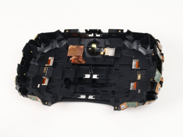

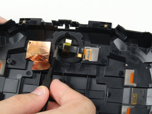

  23. HTC Vive Camera Replacement, Camera: crwdns2935265:023crwdnd2935265:01crwdnd2935265:02crwdne2935265:0 HTC Vive Camera Replacement, Camera: crwdns2935265:023crwdnd2935265:02crwdnd2935265:02crwdne2935265:0
    • Flip the sensor array over 180 degrees.
    • Using tweezers, move the copper tape covering the camera to the side so you can see the screws holding the camera.

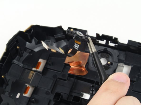

  24. HTC Vive Camera Replacement: crwdns2935265:024crwdnd2935265:01crwdnd2935265:03crwdne2935265:0 HTC Vive Camera Replacement: crwdns2935265:024crwdnd2935265:02crwdnd2935265:03crwdne2935265:0 HTC Vive Camera Replacement: crwdns2935265:024crwdnd2935265:03crwdnd2935265:03crwdne2935265:0
    • Remove the two 2mm #00 Philips screws securing the camera.
    • Use tweezers to pull the now freed camera from its slot.
