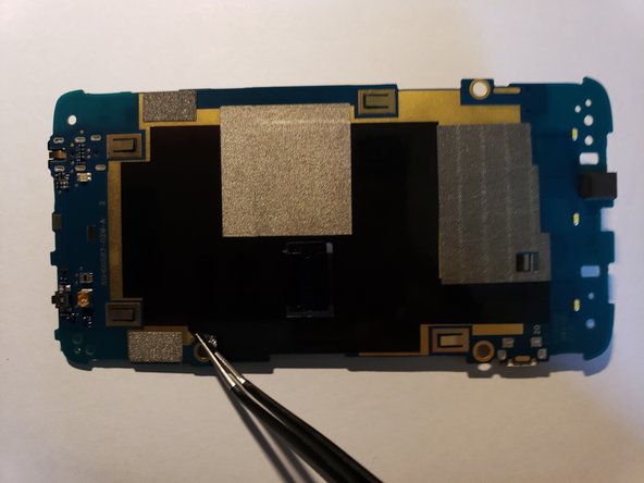

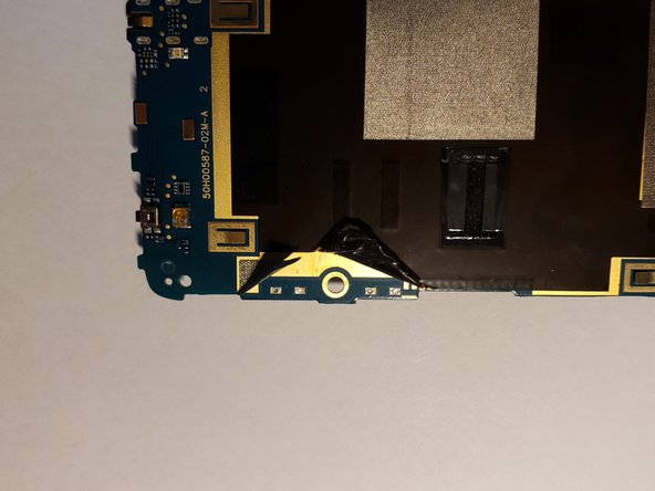

  10. HTC Trophy Volume Buttons Replacement, Volume Buttons: crwdns2935265:010crwdnd2935265:01crwdnd2935265:03crwdne2935265:0 HTC Trophy Volume Buttons Replacement, Volume Buttons: crwdns2935265:010crwdnd2935265:02crwdnd2935265:03crwdne2935265:0 HTC Trophy Volume Buttons Replacement, Volume Buttons: crwdns2935265:010crwdnd2935265:03crwdnd2935265:03crwdne2935265:0

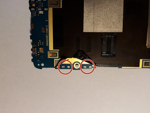

    • Peel back the protective tape with tweezers to expose the solder.
  11. HTC Trophy Volume Buttons Replacement: crwdns2935265:011crwdnd2935265:01crwdnd2935265:02crwdne2935265:0 HTC Trophy Volume Buttons Replacement: crwdns2935265:011crwdnd2935265:02crwdnd2935265:02crwdne2935265:0
    • Desolder the volume buttons off of the motherboard.
    • Be careful not to overheat other components on the motherboard.
    • For more information on soldering and desoldering connections, please read the How to Solder and Desolder Connections guide.
