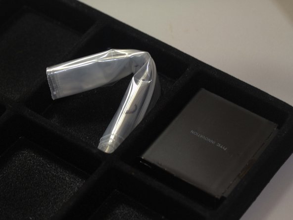

    1. HTC Touch Pro CDMA Verizon Keyboard Replacement, Basic Parts: crwdns2935265:03crwdnd2935265:01crwdnd2935265:01crwdne2935265:0
      • Place the battery in a container off to the side. If you do this for every step beyond this point, you will keep better track of your parts and make reassembling the device far easier when you get around to it.

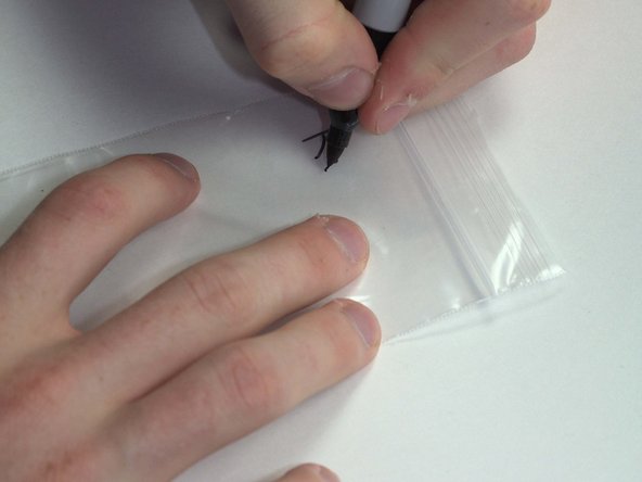

    2. HTC Touch Pro CDMA Verizon Keyboard Replacement: crwdns2935265:04crwdnd2935265:01crwdnd2935265:03crwdne2935265:0 HTC Touch Pro CDMA Verizon Keyboard Replacement: crwdns2935265:04crwdnd2935265:02crwdnd2935265:03crwdne2935265:0 HTC Touch Pro CDMA Verizon Keyboard Replacement: crwdns2935265:04crwdnd2935265:03crwdnd2935265:03crwdne2935265:0
      • Use a T6 screwdriver to remove the four screws on the rear plate of the HTC Touch Pro.
      • Place your screws in a bag labeled with where they came from, what screwdriver you used, and the order in which you removed them. For example, this bag would say "Rear casing. T6. #1."

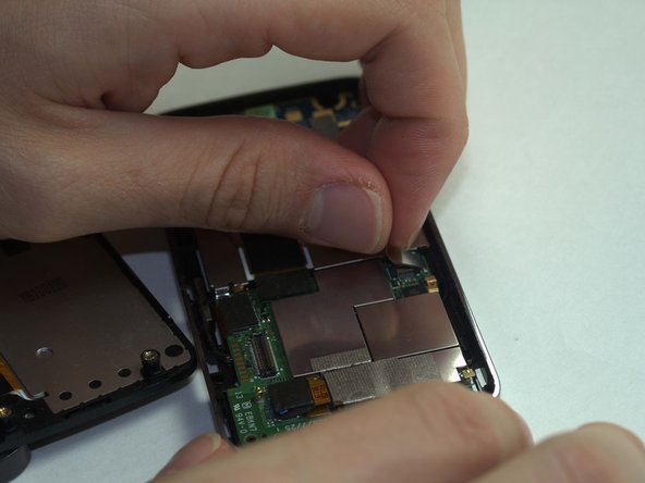

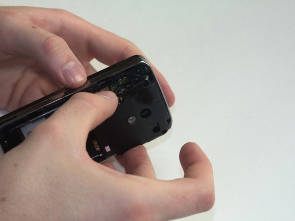

    3. HTC Touch Pro CDMA Verizon Keyboard Replacement: crwdns2935265:05crwdnd2935265:01crwdnd2935265:03crwdne2935265:0 HTC Touch Pro CDMA Verizon Keyboard Replacement: crwdns2935265:05crwdnd2935265:02crwdnd2935265:03crwdne2935265:0 HTC Touch Pro CDMA Verizon Keyboard Replacement: crwdns2935265:05crwdnd2935265:03crwdnd2935265:03crwdne2935265:0

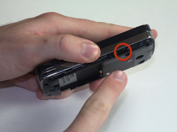

      • Next, remove the casing that covers the camera and motherboard.
      • To do this, place your thumbnail in any of the grooves along either side and pry it open.

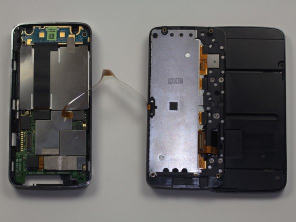

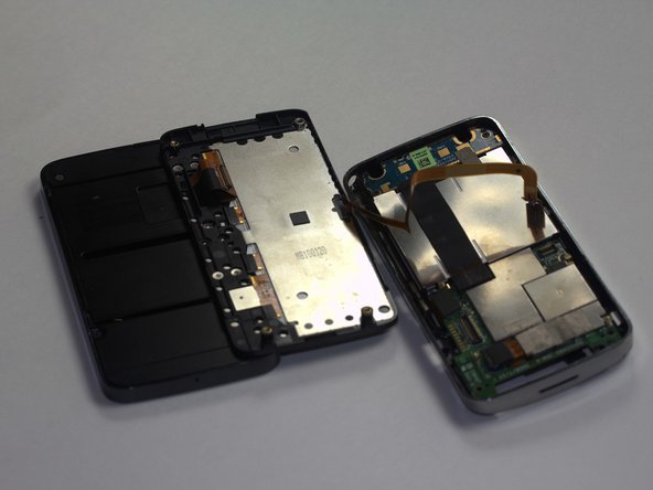

    4. HTC Touch Pro CDMA Verizon Keyboard Replacement: crwdns2935265:06crwdnd2935265:01crwdnd2935265:02crwdne2935265:0 HTC Touch Pro CDMA Verizon Keyboard Replacement: crwdns2935265:06crwdnd2935265:02crwdnd2935265:02crwdne2935265:0
      • Insert your spudger along the slit between the keyboard and the external casing. Pry open as shown.
      • Careful! The ribbon connecting the keyboard to the motherboard will still connect the two halves of the phone when you separate them. Be sure to take your time and move slowly to avoid damage to the cable.

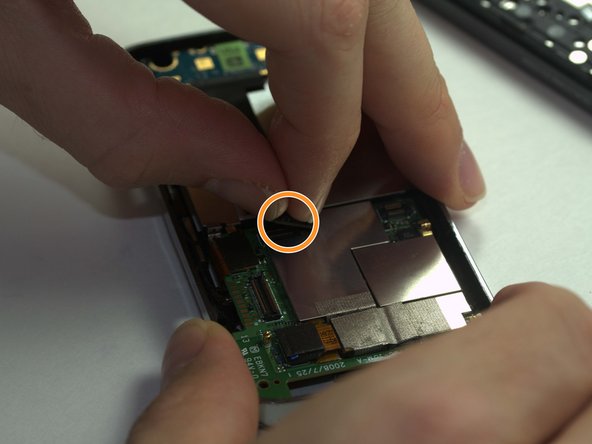

    5. HTC Touch Pro CDMA Verizon Keyboard Replacement: crwdns2935265:07crwdnd2935265:01crwdnd2935265:03crwdne2935265:0 HTC Touch Pro CDMA Verizon Keyboard Replacement: crwdns2935265:07crwdnd2935265:02crwdnd2935265:03crwdne2935265:0 HTC Touch Pro CDMA Verizon Keyboard Replacement: crwdns2935265:07crwdnd2935265:03crwdnd2935265:03crwdne2935265:0
      • Remove the keyboard ribbon from the motherboard. To do this, simply grasp the ribbon at its base and pry it up at an angle. The ribbon has a metal end that is easily removed from the motherboard.

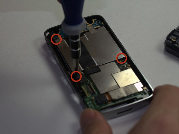

      • Using a Phillips Head size 0 screwdriver, remove the 3 screws holding in the battery compartment.
      • Remove the ribbon covering the battery compartment by pinching it at the base and lifting.

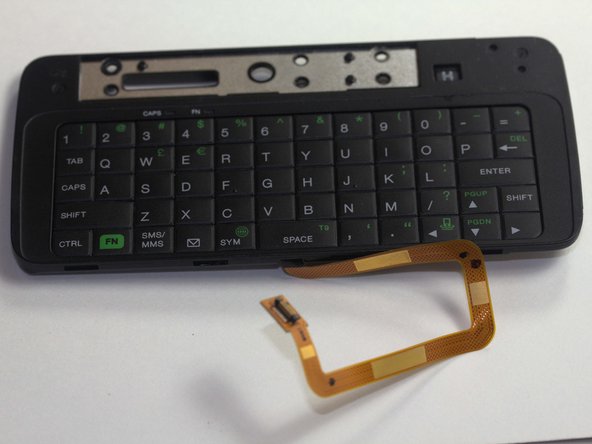

    1. HTC Touch Pro CDMA Verizon Keyboard Replacement, Keyboard: crwdns2935265:09crwdnd2935265:01crwdnd2935265:01crwdne2935265:0
      • Move the black slider over to the side without the keyboard ribbon. This is done as to allow the display ribbon to slide out later.
      • Using a PH 0 screwdriver, remove the 4 screws on the black slider.
    2. HTC Touch Pro CDMA Verizon Keyboard Replacement: crwdns2935265:010crwdnd2935265:01crwdnd2935265:02crwdne2935265:0 HTC Touch Pro CDMA Verizon Keyboard Replacement: crwdns2935265:010crwdnd2935265:02crwdnd2935265:02crwdne2935265:0
      • Pry the keyboard away from the screen. Open on the side containing the keyboard ribbon.
