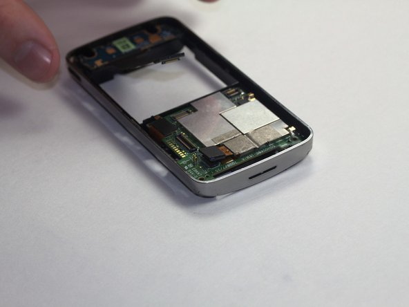

    • Next, remove the casing that covers the camera and motherboard.
    • To do this, place your thumbnail in any of the grooves along either side and pry it open.
  6. HTC Touch Pro CDMA Verizon Camera Replacement: crwdns2935265:06crwdnd2935265:01crwdnd2935265:02crwdne2935265:0 HTC Touch Pro CDMA Verizon Camera Replacement: crwdns2935265:06crwdnd2935265:02crwdnd2935265:02crwdne2935265:0
    • Insert your spudger along the slit between the keyboard and the external casing. Pry open as shown.
    • Careful! The ribbon connecting the keyboard to the motherboard will still connect the two halves of the phone when you separate them. Be sure to take your time and move slowly to avoid damage to the cable.
  7. HTC Touch Pro CDMA Verizon Camera Replacement: crwdns2935265:07crwdnd2935265:01crwdnd2935265:03crwdne2935265:0 HTC Touch Pro CDMA Verizon Camera Replacement: crwdns2935265:07crwdnd2935265:02crwdnd2935265:03crwdne2935265:0 HTC Touch Pro CDMA Verizon Camera Replacement: crwdns2935265:07crwdnd2935265:03crwdnd2935265:03crwdne2935265:0
    • Remove the keyboard ribbon from the motherboard. To do this, simply grasp the ribbon at its base and pry it up at an angle. The ribbon has a metal end that is easily removed from the motherboard.
  8. HTC Touch Pro CDMA Verizon Camera Replacement: crwdns2935265:08crwdnd2935265:01crwdnd2935265:03crwdne2935265:0 HTC Touch Pro CDMA Verizon Camera Replacement: crwdns2935265:08crwdnd2935265:02crwdnd2935265:03crwdne2935265:0 HTC Touch Pro CDMA Verizon Camera Replacement: crwdns2935265:08crwdnd2935265:03crwdnd2935265:03crwdne2935265:0
    • Using a Phillips Head size 0 screwdriver, remove the 3 screws holding in the battery compartment.
    • Remove the ribbon covering the battery compartment by pinching it at the base and lifting.

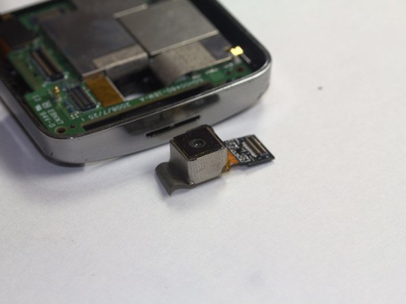

  9. HTC Touch Pro CDMA Verizon Camera Replacement, Camera: crwdns2935265:09crwdnd2935265:01crwdnd2935265:02crwdne2935265:0 HTC Touch Pro CDMA Verizon Camera Replacement, Camera: crwdns2935265:09crwdnd2935265:02crwdnd2935265:02crwdne2935265:0
    • The camera is only held in by one connection to the motherboard and some tape.
    • Remove its connection to motherboard in the same way that you've removed such connections in the past.
  10. HTC Touch Pro CDMA Verizon Camera Replacement: crwdns2935265:010crwdnd2935265:01crwdnd2935265:02crwdne2935265:0 HTC Touch Pro CDMA Verizon Camera Replacement: crwdns2935265:010crwdnd2935265:02crwdnd2935265:02crwdne2935265:0
    • Peel the tape holding it in place.
    • After that it will be free to remove and replace as necessary.
