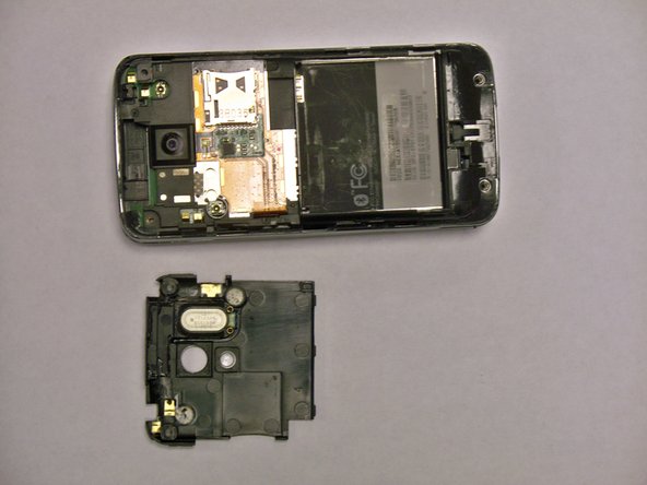

  4. HTC Touch Pro CDMA USB Motherboard Replacement: crwdns2935265:04crwdnd2935265:01crwdnd2935265:02crwdne2935265:0 HTC Touch Pro CDMA USB Motherboard Replacement: crwdns2935265:04crwdnd2935265:02crwdnd2935265:02crwdne2935265:0
    • Lift the plastic cover near the memory card slot.

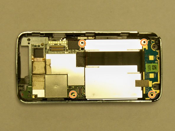

  5. HTC Touch Pro CDMA USB Motherboard Replacement: crwdns2935265:05crwdnd2935265:01crwdnd2935265:01crwdne2935265:0
    • Remove the two Phillips #00 screws from the backside of the screen.

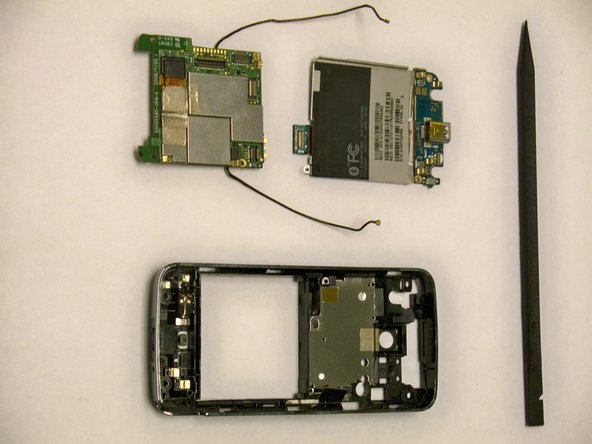

  8. HTC Touch Pro CDMA USB Motherboard Replacement: crwdns2935265:08crwdnd2935265:01crwdnd2935265:02crwdne2935265:0 HTC Touch Pro CDMA USB Motherboard Replacement: crwdns2935265:08crwdnd2935265:02crwdnd2935265:02crwdne2935265:0
    • Gently lift the motherboard up using a nylon spudger.
    • BE AWARE OF THE ANTENNA.
