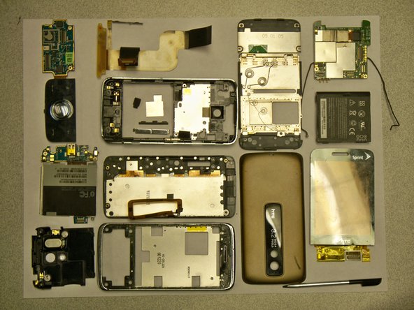

HTC Touch Pro CDMA Screen Replacement
  1. HTC Touch Pro CDMA Screen Replacement, Battery: crwdns2935265:01crwdnd2935265:01crwdnd2935265:02crwdne2935265:0 HTC Touch Pro CDMA Screen Replacement, Battery: crwdns2935265:01crwdnd2935265:02crwdnd2935265:02crwdne2935265:0
    • First, gently press on the back plate and push down toward the camera.
  2. HTC Touch Pro CDMA Screen Replacement: crwdns2935265:02crwdnd2935265:01crwdnd2935265:02crwdne2935265:0 HTC Touch Pro CDMA Screen Replacement: crwdns2935265:02crwdnd2935265:02crwdnd2935265:02crwdne2935265:0
    • Use your finger to lift up the edge of the battery.
  3. HTC Touch Pro CDMA Screen Replacement, USB Logic Board: crwdns2935265:03crwdnd2935265:01crwdnd2935265:01crwdne2935265:0
    • Remove the 4 screws using the T6 screw driver.
  4. HTC Touch Pro CDMA Screen Replacement: crwdns2935265:04crwdnd2935265:01crwdnd2935265:02crwdne2935265:0 HTC Touch Pro CDMA Screen Replacement: crwdns2935265:04crwdnd2935265:02crwdnd2935265:02crwdne2935265:0
    • Lift the plastic cover near the memory card slot.
  5. HTC Touch Pro CDMA Screen Replacement: crwdns2935265:05crwdnd2935265:01crwdnd2935265:01crwdne2935265:0
    • Remove the two Phillips #00 screws from the backside of the screen.

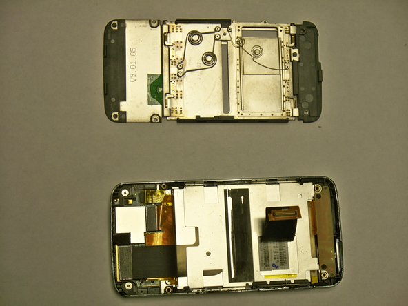

  6. HTC Touch Pro CDMA Screen Replacement: crwdns2935265:06crwdnd2935265:01crwdnd2935265:02crwdne2935265:0 HTC Touch Pro CDMA Screen Replacement: crwdns2935265:06crwdnd2935265:02crwdnd2935265:02crwdne2935265:0
    • Insert a spudger or a plastic opening tool into the seam on the side of the phone.
    • Gently pry apart the two halves of the phone.
  7. HTC Touch Pro CDMA Screen Replacement: crwdns2935265:07crwdnd2935265:01crwdnd2935265:02crwdne2935265:0 HTC Touch Pro CDMA Screen Replacement: crwdns2935265:07crwdnd2935265:02crwdnd2935265:02crwdne2935265:0
    • Gently unplug the connectors.
    • Remove the screws with a 00 Phillips-head screwdriver.
  8. HTC Touch Pro CDMA Screen Replacement: crwdns2935265:08crwdnd2935265:01crwdnd2935265:02crwdne2935265:0 HTC Touch Pro CDMA Screen Replacement: crwdns2935265:08crwdnd2935265:02crwdnd2935265:02crwdne2935265:0
    • Gently lift the motherboard up using a nylon spudger.
    • BE AWARE OF THE ANTENNA.
  9. HTC Touch Pro CDMA Screen Replacement, Keyboard: crwdns2935265:09crwdnd2935265:01crwdnd2935265:02crwdne2935265:0 HTC Touch Pro CDMA Screen Replacement, Keyboard: crwdns2935265:09crwdnd2935265:02crwdnd2935265:02crwdne2935265:0
    • Remove the 4 screws circled in red using a 00 Phillips-head screwdriver.
  10. HTC Touch Pro CDMA Screen Replacement, Screen: crwdns2935265:010crwdnd2935265:01crwdnd2935265:02crwdne2935265:0 HTC Touch Pro CDMA Screen Replacement, Screen: crwdns2935265:010crwdnd2935265:02crwdnd2935265:02crwdne2935265:0
    • Start by lifting the back plate of the screen by using yours finger or a plastic opener tool.
  11. HTC Touch Pro CDMA Screen Replacement: crwdns2935265:011crwdnd2935265:01crwdnd2935265:01crwdne2935265:0
    • Remove the 4 screws by using a 00 Phillips-head screwdriver.
    • Gently lift the connectors.

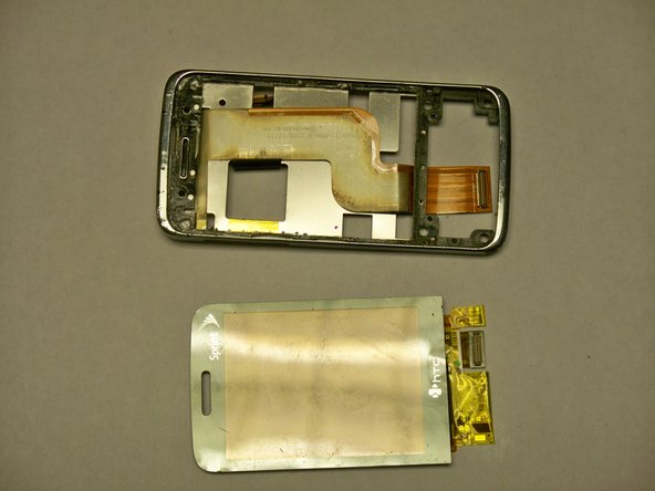

  12. HTC Touch Pro CDMA Screen Replacement: crwdns2935265:012crwdnd2935265:01crwdnd2935265:01crwdne2935265:0
    • Lift the front keyboard by removing the screws with a 00 Phillips-head screwdriver.
  13. HTC Touch Pro CDMA Screen Replacement: crwdns2935265:013crwdnd2935265:01crwdnd2935265:03crwdne2935265:0 HTC Touch Pro CDMA Screen Replacement: crwdns2935265:013crwdnd2935265:02crwdnd2935265:03crwdne2935265:0 HTC Touch Pro CDMA Screen Replacement: crwdns2935265:013crwdnd2935265:03crwdnd2935265:03crwdne2935265:0
    • With the front keyboard removed, gently lift the screen up with a plastic opener tool and remove it .
