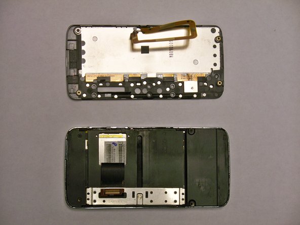

    • Gently unplug the connectors.
    • Remove the screws with a 00 Phillips-head screwdriver.
  8. HTC Touch Pro CDMA Keyboard Replacement: crwdns2935265:08crwdnd2935265:01crwdnd2935265:02crwdne2935265:0 HTC Touch Pro CDMA Keyboard Replacement: crwdns2935265:08crwdnd2935265:02crwdnd2935265:02crwdne2935265:0
    • Gently lift the motherboard up using a nylon spudger.
    • BE AWARE OF THE ANTENNA.
  9. HTC Touch Pro CDMA Keyboard Replacement, Keyboard: crwdns2935265:09crwdnd2935265:01crwdnd2935265:02crwdne2935265:0 HTC Touch Pro CDMA Keyboard Replacement, Keyboard: crwdns2935265:09crwdnd2935265:02crwdnd2935265:02crwdne2935265:0
    • Remove the 4 screws circled in red using a 00 Phillips-head screwdriver.
