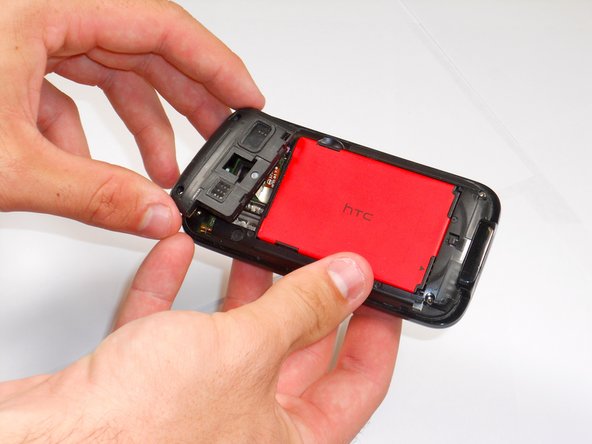

    • Lift battery upward on the upper right-hand side to remove it.
    • Check the battery to make sure there's no bent corners.

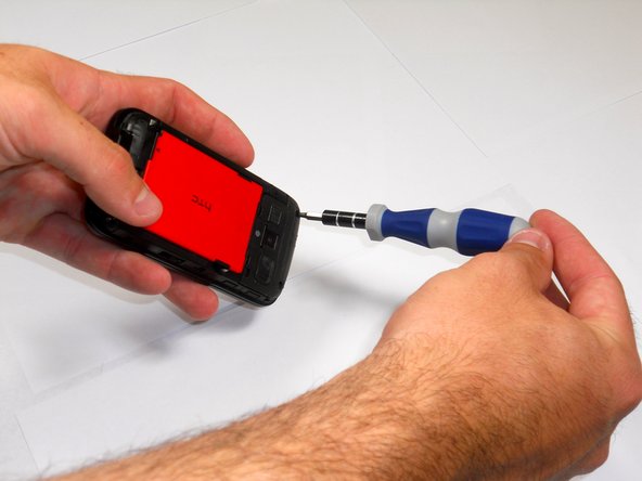

    • Remove the four screws from the corners of the phone using a T5 Torx screwdriver.

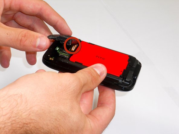

    • Lift the top segment of the phone frame off.
    • Be cautious with the ribbon on the back of this part.

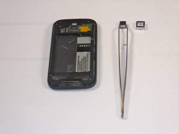

    • Use the tweezers to pull the camera cover up and away from the phone. Repeat for the camera underneath.
