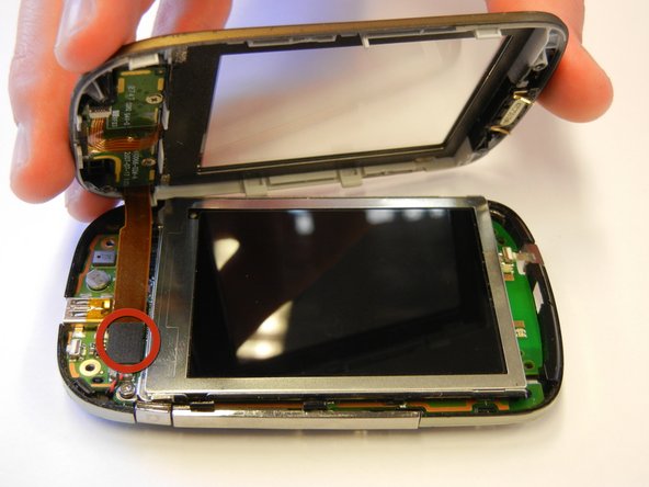

      • Use the plastic opening tool to remove the front panel from the phone.
      • Unplug the front button cable from the inside of the phone.

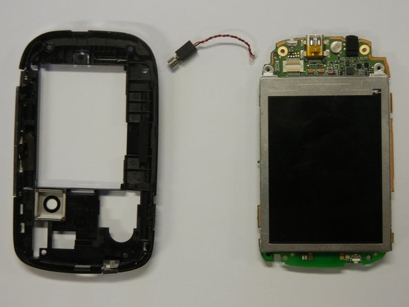

      • Separate the motherboard from the black plastic casing.
      • Unplug the black and red wire from the motherboard.
      • Unplug the black and red wire from the black plastic casing.
