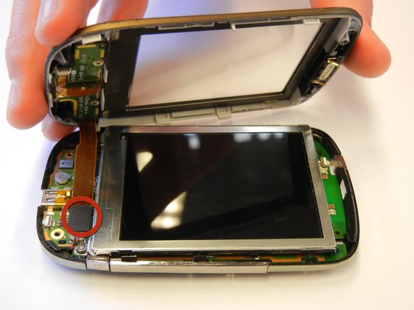

      • Use the plastic opening tool to remove the front panel from the phone.
      • Unplug the front button cable from the inside of the phone.
