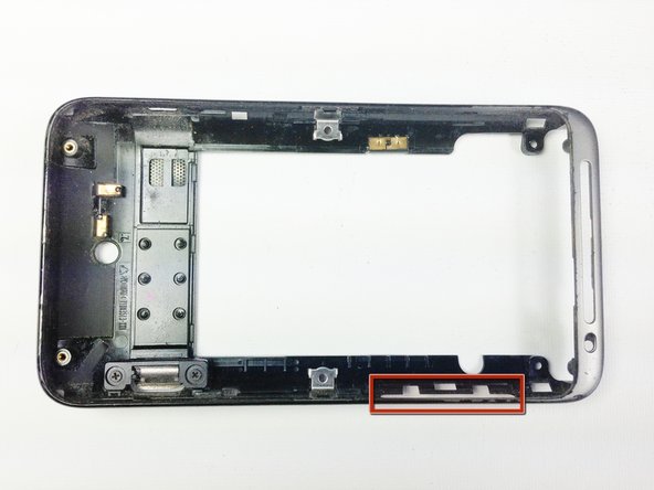

    1. HTC Thunderbolt Volume Buttons Replacement, Volume Buttons: crwdns2935265:011crwdnd2935265:01crwdnd2935265:01crwdne2935265:0
      • Locate the side volume buttons
    2. HTC Thunderbolt Volume Buttons Replacement: crwdns2935265:012crwdnd2935265:01crwdnd2935265:02crwdne2935265:0 HTC Thunderbolt Volume Buttons Replacement: crwdns2935265:012crwdnd2935265:02crwdnd2935265:02crwdne2935265:0
      • Use a pry tool to lift the buttons out of the case
