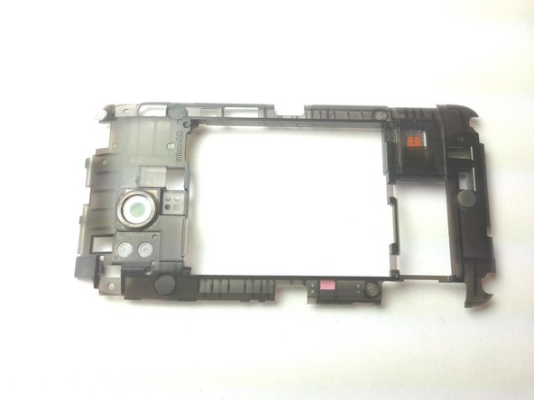

  9. HTC Thunderbolt Speaker Replacement, Rear Inner Frame: crwdns2935265:09crwdnd2935265:01crwdnd2935265:01crwdne2935265:0
    • Remove the two Phillips screws securing rear inner frame to device.
  10. HTC Thunderbolt Speaker Replacement: crwdns2935265:010crwdnd2935265:01crwdnd2935265:01crwdne2935265:0
    • Insert the plastic opening tool between the rear inner frame and the motherboard and slowly work your way around the device.
  11. HTC Thunderbolt Speaker Replacement: crwdns2935265:011crwdnd2935265:01crwdnd2935265:02crwdne2935265:0 HTC Thunderbolt Speaker Replacement: crwdns2935265:011crwdnd2935265:02crwdnd2935265:02crwdne2935265:0
    • Remove the rear inner frame from the rest of the device.

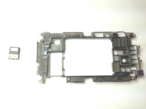

  12. HTC Thunderbolt Speaker Replacement, Speaker: crwdns2935265:012crwdnd2935265:01crwdnd2935265:01crwdne2935265:0
    • Flip over rear inner frame.
  13. HTC Thunderbolt Speaker Replacement: crwdns2935265:013crwdnd2935265:01crwdnd2935265:02crwdne2935265:0 HTC Thunderbolt Speaker Replacement: crwdns2935265:013crwdnd2935265:02crwdnd2935265:02crwdne2935265:0
    • Pry out speaker with plastic opening tools.
    • You have now removed the speaker.
