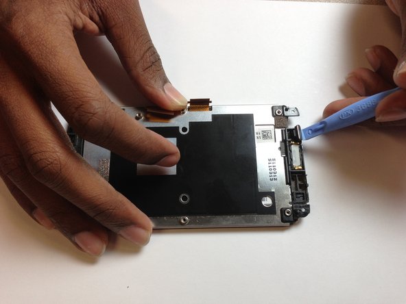

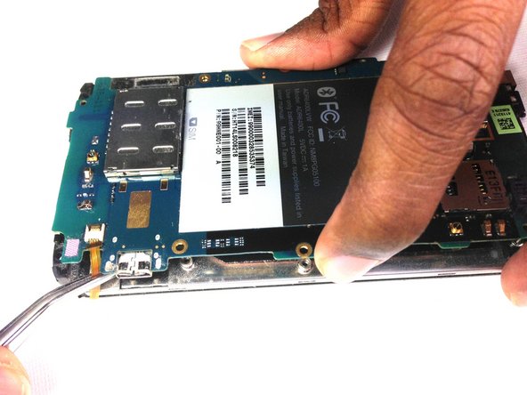

    1. HTC Thunderbolt Power Button Replacement, LCD/Screen: crwdns2935265:012crwdnd2935265:01crwdnd2935265:02crwdne2935265:0 HTC Thunderbolt Power Button Replacement, LCD/Screen: crwdns2935265:012crwdnd2935265:02crwdnd2935265:02crwdne2935265:0
      • Using the tip of an plastic opening tool flip up the tab holding the capacitive button ribbon cable.
      • Be careful opening these tabs as they are very easy to break.
      • Use a pair of tweezers to pull the capacitive button cable out of its socket.

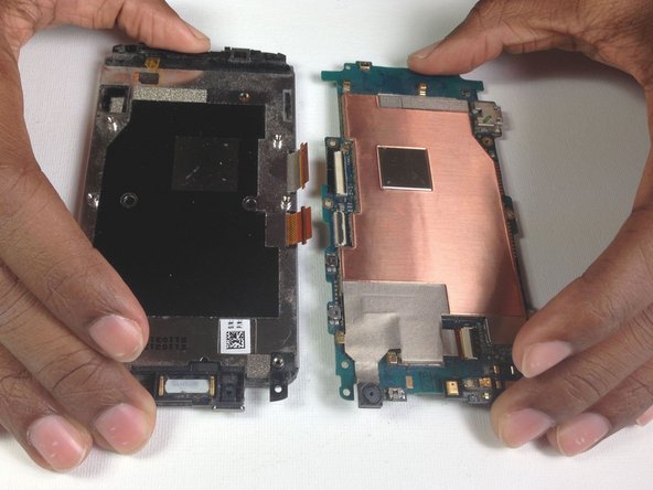

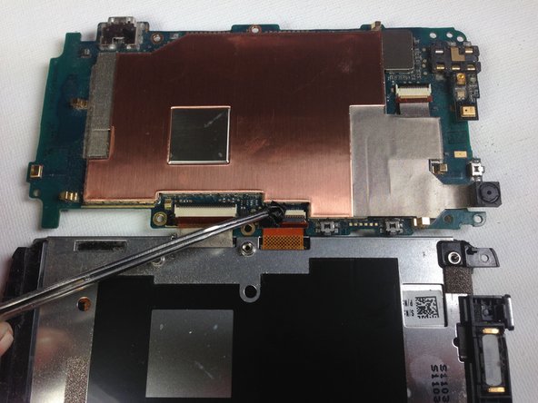

    2. HTC Thunderbolt Power Button Replacement: crwdns2935265:013crwdnd2935265:01crwdnd2935265:02crwdne2935265:0 HTC Thunderbolt Power Button Replacement: crwdns2935265:013crwdnd2935265:02crwdnd2935265:02crwdne2935265:0
      • Lifting from the side where the ribbon was disconnected, flip over the motherboard.
      • Remove the black tape covering the tabs connecting the motherboard and LCD.
    3. HTC Thunderbolt Power Button Replacement: crwdns2935265:014crwdnd2935265:01crwdnd2935265:01crwdne2935265:0
      • Using the plastic opening tool pop up the two tabs connecting the LCD and motherboard.
    4. HTC Thunderbolt Power Button Replacement: crwdns2935265:015crwdnd2935265:01crwdnd2935265:02crwdne2935265:0 HTC Thunderbolt Power Button Replacement: crwdns2935265:015crwdnd2935265:02crwdnd2935265:02crwdne2935265:0
      • Once the tabs have been popped up, slowly pull the two pieces away from each other.
      • If there is resistance pulling apart the phone then a ribbon or tab has not been disconnected properly/completely.

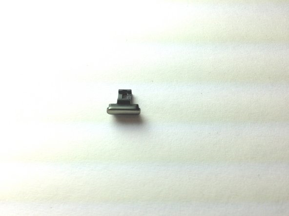

    1. HTC Thunderbolt Power Button Replacement, Power Button: crwdns2935265:016crwdnd2935265:01crwdnd2935265:03crwdne2935265:0 HTC Thunderbolt Power Button Replacement, Power Button: crwdns2935265:016crwdnd2935265:02crwdnd2935265:03crwdne2935265:0 HTC Thunderbolt Power Button Replacement, Power Button: crwdns2935265:016crwdnd2935265:03crwdnd2935265:03crwdne2935265:0
      • Flip the LCD over so that it is facing downward.
      • Pry out the power button with a plastic opening tool.
      • You have now removed the power button.
