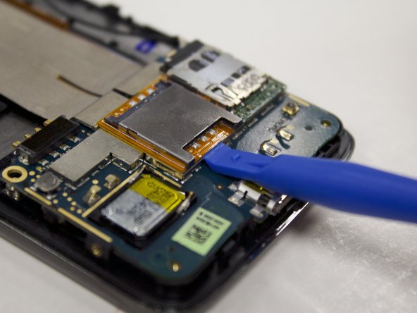

  4. HTC Surround Motherboard Replacement, SD Card: crwdns2935265:04crwdnd2935265:01crwdnd2935265:03crwdne2935265:0 HTC Surround Motherboard Replacement, SD Card: crwdns2935265:04crwdnd2935265:02crwdnd2935265:03crwdne2935265:0 HTC Surround Motherboard Replacement, SD Card: crwdns2935265:04crwdnd2935265:03crwdnd2935265:03crwdne2935265:0
    • Look at the bottom right hand corner of the device and remove the silver tape covering the SD card slot with your fingers.
    • Insert the plastic opening tool directly underneath the orange surface below the SIM card until its removed from the surface of the device.
  5. HTC Surround Motherboard Replacement: crwdns2935265:05crwdnd2935265:01crwdnd2935265:02crwdne2935265:0 HTC Surround Motherboard Replacement: crwdns2935265:05crwdnd2935265:02crwdnd2935265:02crwdne2935265:0
    • To get to the attachment that the SD/SIM card is attached to; insert the plastic opening tool underneath the lower motherboard until it is removed from the bottom half of the device.
    • You will notice the SD/SIM card is attached to the lower motherboard by a yellow piece of tape. Remove the tape from the back of motherboard with your fingers.
