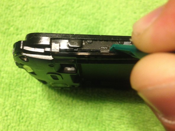

    • DO NOT pry loose as shown in this picture. The button in the middle that is pictured can be pressed in, releasing the back housing which can then be easily lifted free.

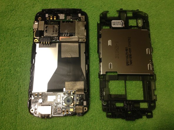

  5. HTC Sensation Touchscreen/Digitzer Replacement: crwdns2935265:05crwdnd2935265:01crwdnd2935265:01crwdne2935265:0
    • Remove the one Phillips head screw from the motherboard.
    • Remove the silver tape/adhesive covering 2 jawbone connectors.

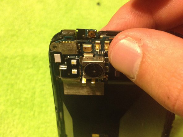

    • Remove the same black plastic from the top power button. Be careful to only remove the plastic as there is a flex cable under.
    • Go ahead and carefully pull the power button flex up.
  9. HTC Sensation Touchscreen/Digitzer Replacement: crwdns2935265:09crwdnd2935265:01crwdnd2935265:03crwdne2935265:0 HTC Sensation Touchscreen/Digitzer Replacement: crwdns2935265:09crwdnd2935265:02crwdnd2935265:03crwdne2935265:0 HTC Sensation Touchscreen/Digitzer Replacement: crwdns2935265:09crwdnd2935265:03crwdnd2935265:03crwdne2935265:0

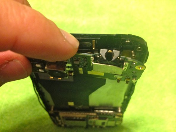

    • With the power button flex up you can now carefully pull up the motherboard.
    • BE CAREFUL as there are still two cables connected to jawbone connectors on the underside of the motherboard.
    • On the underside you will barely see the jawbone connectors. Go ahead and flip them open to release the cables.

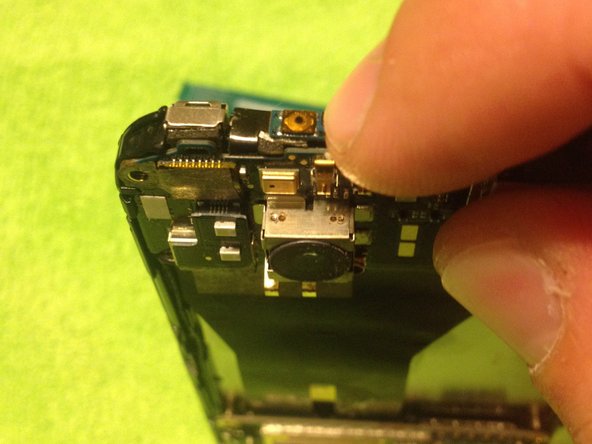

  10. HTC Sensation Touchscreen/Digitzer Replacement: crwdns2935265:010crwdnd2935265:01crwdnd2935265:02crwdne2935265:0 HTC Sensation Touchscreen/Digitzer Replacement: crwdns2935265:010crwdnd2935265:02crwdnd2935265:02crwdne2935265:0
    • Before lifting up the motherboard, be sure to release the 2nd jawbone connector. This one is for the touchscreen/digitizer. (Photo is with motherboard already out to show you exactly where it is.
    • With the flex cable removed you can now lift up on the motherboard. There is still a cable attached, but it is the touchscreen/digitizer cable. So, if you have a broken screen it IS ok if you break this cable.

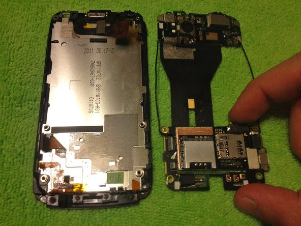

  11. HTC Sensation Touchscreen/Digitzer Replacement: crwdns2935265:011crwdnd2935265:01crwdnd2935265:02crwdne2935265:0 HTC Sensation Touchscreen/Digitzer Replacement: crwdns2935265:011crwdnd2935265:02crwdnd2935265:02crwdne2935265:0
    • Now can you completely remove the motherboard.
    • There are little "teeth" around the mother board so if you are having some trouble it's because the motherboard is still caught under the teeth.

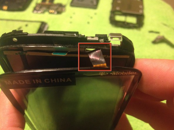

    • Remove the top layer of sticky black tape, then prep the LCD assembly and new touchscreen/digitizer with new adhesive--I just used thin strips of two-sided tape.
    • Using a microfiber cloth remove any dust from the LCD display.
    • Slide the new touchscreen/digitizer cable between the frame and LCD display.
    • Be VERY careful with the touchscreen/digitizer cable! If needed, it is ok to lightly and carefully push against the backside of the LCD to create more space. You may need to pull the cable through forcefully; just don't rip it or break the LCD.
    • Once the cable is through go ahead and remove all paper from adhesives and set the screen in place.
    • Now you can begin reconstructing your phone. Go ahead and go through the steps backwards.
    • Reattaching the cables is the trickiest part but not impossible.
