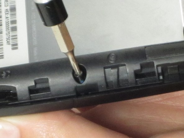

  4. HTC SMT 6175 Motherboard Replacement, Interior Back Case: crwdns2935265:04crwdnd2935265:01crwdnd2935265:02crwdne2935265:0 HTC SMT 6175 Motherboard Replacement, Interior Back Case: crwdns2935265:04crwdnd2935265:02crwdnd2935265:02crwdne2935265:0
    • To remove the case, use a small, pentagonal screwdriver to unscrew the 6 screws that can be found around the edges.

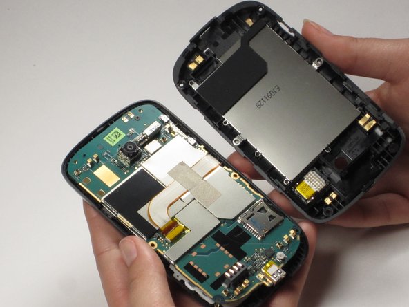

  5. HTC SMT 6175 Motherboard Replacement: crwdns2935265:05crwdnd2935265:01crwdnd2935265:02crwdne2935265:0 HTC SMT 6175 Motherboard Replacement: crwdns2935265:05crwdnd2935265:02crwdnd2935265:02crwdne2935265:0
    • Pull off the case.
    • This can be difficult. Just start pulling the back out from the front shell and, as it starts to lift up, continue moving around the phone until the whole back becomes free.

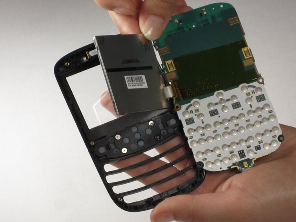

  6. HTC SMT 6175 Motherboard Replacement, Taking out the Motherboard: crwdns2935265:06crwdnd2935265:01crwdnd2935265:01crwdne2935265:0
    • Next, unscrew the top screw using a small, Philips screwdriver.
    • Pull back the motherboard.
    • The LCD screen is still attached to the front side of the motherboard by a flexible ribbon cable and to the front case by an adhesive.
  7. HTC SMT 6175 Motherboard Replacement, Taking out the Display Screen: crwdns2935265:07crwdnd2935265:01crwdnd2935265:02crwdne2935265:0 HTC SMT 6175 Motherboard Replacement, Taking out the Display Screen: crwdns2935265:07crwdnd2935265:02crwdnd2935265:02crwdne2935265:0
    • Using a spudger, remove the display screen from its cell within the front case. Insert the spudger next to the LCD on the opposite side of where the motherboard is attached.
    • The LCD is attached with a sticky adhesive so it might be difficult to get off.
