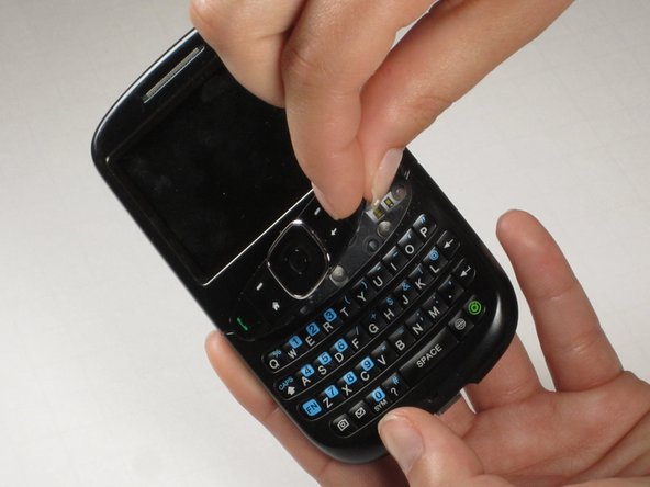

      • First, flip the phone over so that the back is facing upwards.
    2. HTC SMT 6175 Keyboard Replacement: crwdns2935265:02crwdnd2935265:01crwdnd2935265:02crwdne2935265:0 HTC SMT 6175 Keyboard Replacement: crwdns2935265:02crwdnd2935265:02crwdnd2935265:02crwdne2935265:0
      • Using both thumbs, push the back side of the phone's exterior up and remove the front face of the phone.

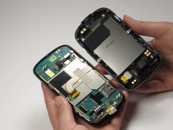

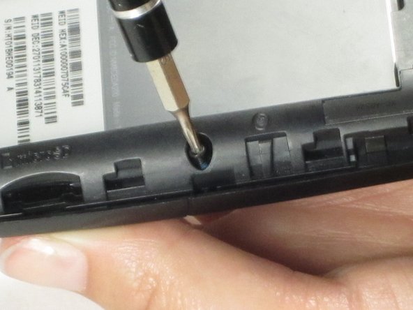

    1. HTC SMT 6175 Keyboard Replacement, Keyboard: crwdns2935265:04crwdnd2935265:01crwdnd2935265:02crwdne2935265:0 HTC SMT 6175 Keyboard Replacement, Keyboard: crwdns2935265:04crwdnd2935265:02crwdnd2935265:02crwdne2935265:0
      • To remove the back casing inside the phone, remove the six screws around the perimeter.
    2. HTC SMT 6175 Keyboard Replacement: crwdns2935265:05crwdnd2935265:01crwdnd2935265:02crwdne2935265:0 HTC SMT 6175 Keyboard Replacement: crwdns2935265:05crwdnd2935265:02crwdnd2935265:02crwdne2935265:0
      • Carefully pull off the back casing.
      • This step may be difficult. Start pulling the back out from the front shell. As it starts to lift up, move the phone side-to-side until the whole back is free.

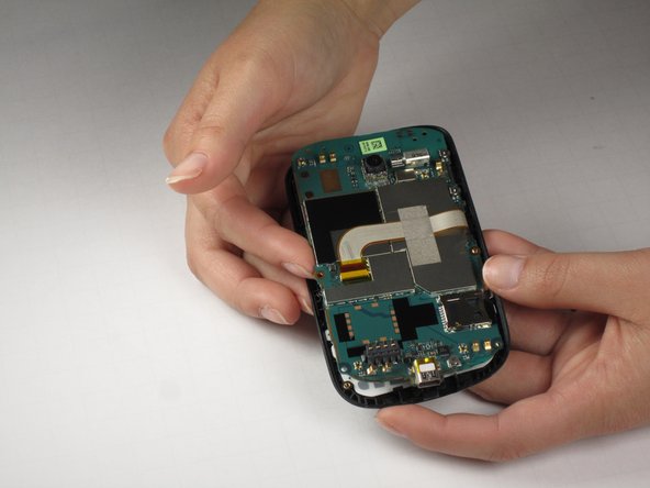

    3. HTC SMT 6175 Keyboard Replacement: crwdns2935265:06crwdnd2935265:01crwdnd2935265:02crwdne2935265:0 HTC SMT 6175 Keyboard Replacement: crwdns2935265:06crwdnd2935265:02crwdnd2935265:02crwdne2935265:0
      • Remove the top screw.
      • Be CAREFUL, because the LCD screen is attached to the front side of the motherboard by a flexible ribbon cable.

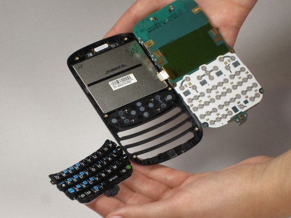

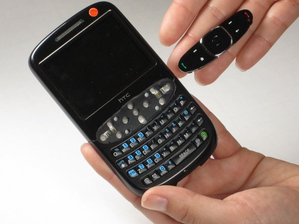

    4. HTC SMT 6175 Keyboard Replacement, QWERTY Keyboard: crwdns2935265:07crwdnd2935265:01crwdnd2935265:03crwdne2935265:0 HTC SMT 6175 Keyboard Replacement, QWERTY Keyboard: crwdns2935265:07crwdnd2935265:02crwdnd2935265:03crwdne2935265:0 HTC SMT 6175 Keyboard Replacement, QWERTY Keyboard: crwdns2935265:07crwdnd2935265:03crwdnd2935265:03crwdne2935265:0
      • Pull the plastic keyboard away from the front case.

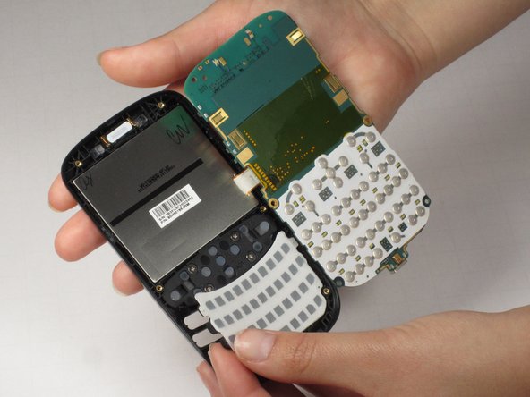

    5. HTC SMT 6175 Keyboard Replacement, Navigation Keys: crwdns2935265:08crwdnd2935265:01crwdnd2935265:03crwdne2935265:0 HTC SMT 6175 Keyboard Replacement, Navigation Keys: crwdns2935265:08crwdnd2935265:02crwdnd2935265:03crwdne2935265:0 HTC SMT 6175 Keyboard Replacement, Navigation Keys: crwdns2935265:08crwdnd2935265:03crwdnd2935265:03crwdne2935265:0
      • To remove the navigation keys on the front of the phone, remove the four screws securing the navigation keys using a Phillips screwdriver.
      • Remove the navigation keys from the front of the phone.
      • They should pop out as a unit.
