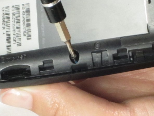

  4. HTC SMT 6175 Ear Speaker Replacement, Speaker: crwdns2935265:04crwdnd2935265:01crwdnd2935265:02crwdne2935265:0 HTC SMT 6175 Ear Speaker Replacement, Speaker: crwdns2935265:04crwdnd2935265:02crwdnd2935265:02crwdne2935265:0
    • Next, choose the matching tool from your driver kit and remove the six screws found around the perimeter of the phone.
    • Once the screws are removed make sure to keep them in a safe place for reassembly.

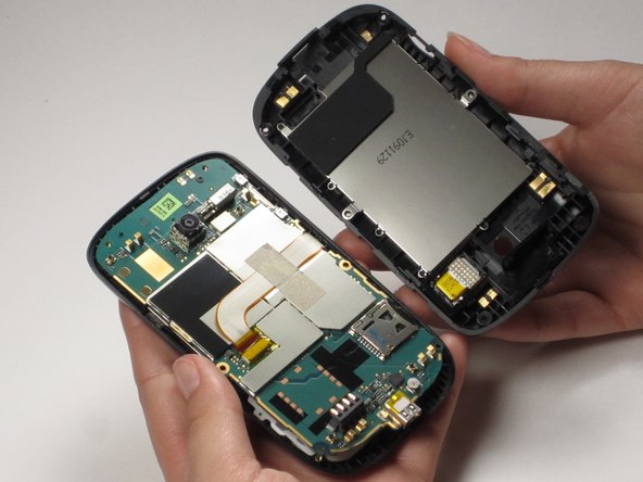

  6. HTC SMT 6175 Ear Speaker Replacement: crwdns2935265:06crwdnd2935265:01crwdnd2935265:01crwdne2935265:0
    • Next, remove the top screw.
    • Be careful! The LCD screen is still attached to the front of the motherboard by a flexible ribbon cable.

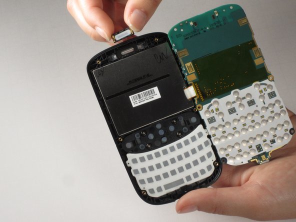

  7. HTC SMT 6175 Ear Speaker Replacement: crwdns2935265:07crwdnd2935265:01crwdnd2935265:02crwdne2935265:0 HTC SMT 6175 Ear Speaker Replacement: crwdns2935265:07crwdnd2935265:02crwdnd2935265:02crwdne2935265:0
    • Flip over the motherboard so that the front case is visible. Using a spudger, remove the speaker out of its holding cell.
