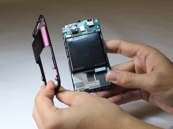

    4. HTC Rhyme Volume Button  Replacement, Remove the plastic cover: crwdns2935265:04crwdnd2935265:01crwdnd2935265:01crwdne2935265:0
      • Remove the plastic cover using your hands.

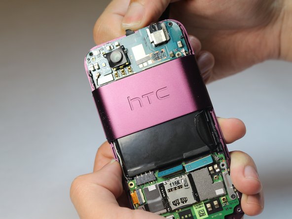

    5. HTC Rhyme Volume Button  Replacement: crwdns2935265:05crwdnd2935265:01crwdnd2935265:01crwdne2935265:0
      • Remove the yellow ribbon.
    6. HTC Rhyme Volume Button  Replacement: crwdns2935265:06crwdnd2935265:01crwdnd2935265:03crwdne2935265:0 HTC Rhyme Volume Button  Replacement: crwdns2935265:06crwdnd2935265:02crwdnd2935265:03crwdne2935265:0 HTC Rhyme Volume Button  Replacement: crwdns2935265:06crwdnd2935265:03crwdnd2935265:03crwdne2935265:0
      • Lift up the blue flaps underneath the battery.
      • Lift up the black flap at the top of the phone.
      • Lift up the black flap at the bottom of the phone.

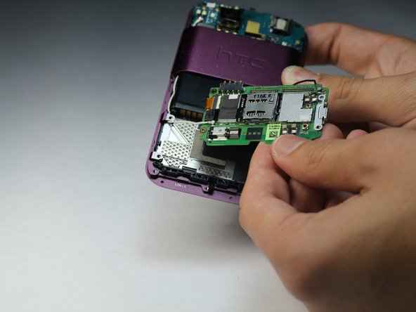

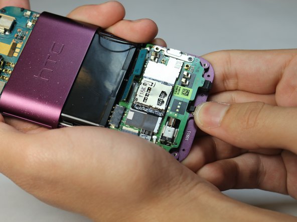

    7. HTC Rhyme Volume Button  Replacement, Remove the Motherboard: crwdns2935265:07crwdnd2935265:01crwdnd2935265:02crwdne2935265:0 HTC Rhyme Volume Button  Replacement, Remove the Motherboard: crwdns2935265:07crwdnd2935265:02crwdnd2935265:02crwdne2935265:0
      • Remove all 4 screws.
      • Carefully remove the motherboard with your hands.

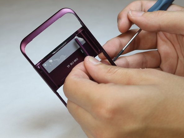

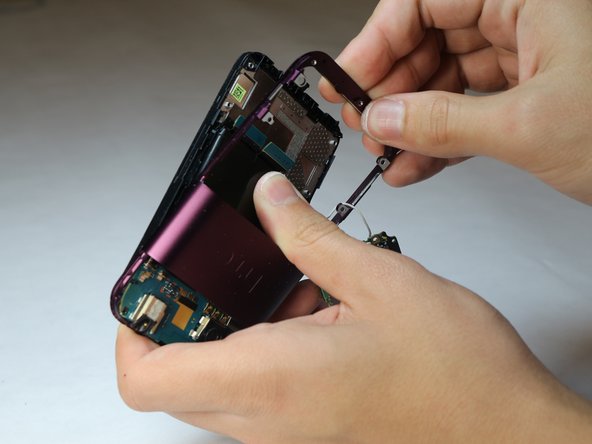

      • Pry the back plastic casing off with your hands.
    9. HTC Rhyme Volume Button  Replacement: crwdns2935265:09crwdnd2935265:01crwdnd2935265:02crwdne2935265:0 HTC Rhyme Volume Button  Replacement: crwdns2935265:09crwdnd2935265:02crwdnd2935265:02crwdne2935265:0
      • Use the tip of a screwdriver to push the button out of the panel.
