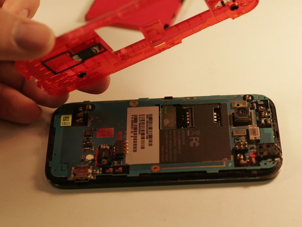

    • Use a plastic opening tool or your fingers to get into the groove between the cover and case. Remove the back covering so that the red battery is visible.
  2. HTC Rezound Vibration Monitor Replacement: crwdns2935265:02crwdnd2935265:01crwdnd2935265:01crwdne2935265:0
    • Remove the red battery to replace.

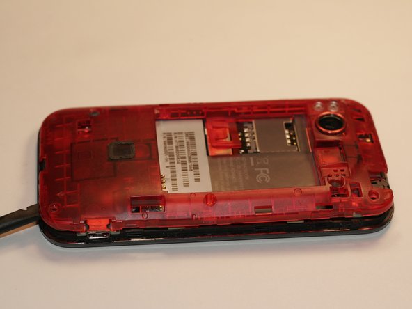

    • Using a Torx T4 screwdriver, remove the six screws from the six spots shown in the photo.
    • Use a spudger to pry the casing from the phone.

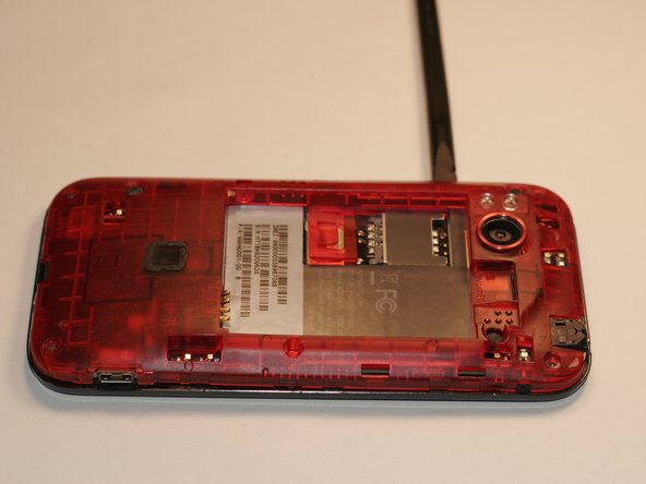

  4. HTC Rezound Vibration Monitor Replacement: crwdns2935265:04crwdnd2935265:01crwdnd2935265:02crwdne2935265:0 HTC Rezound Vibration Monitor Replacement: crwdns2935265:04crwdnd2935265:02crwdnd2935265:02crwdne2935265:0
    • Gently remove casing from phone.

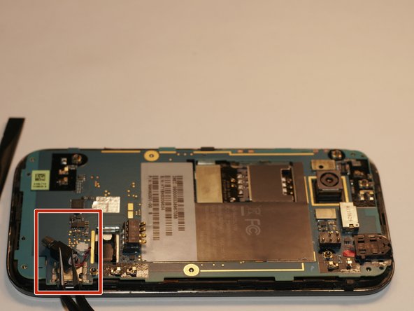

    • Shown here is the vibration Monitor, this is what you will be replacing.
  6. HTC Rezound Vibration Monitor Replacement: crwdns2935265:06crwdnd2935265:01crwdnd2935265:03crwdne2935265:0 HTC Rezound Vibration Monitor Replacement: crwdns2935265:06crwdnd2935265:02crwdnd2935265:03crwdne2935265:0 HTC Rezound Vibration Monitor Replacement: crwdns2935265:06crwdnd2935265:03crwdnd2935265:03crwdne2935265:0
    • Remove the body of the monitor from the case attaching it to the motherboard.
    • Make sure to remove any potential obstruction that could be blocking the weight at the end!

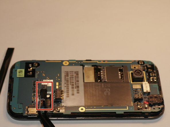

    • Carefully disconnect the cable attached at the motherboard.
  8. HTC Rezound Vibration Monitor Replacement: crwdns2935265:08crwdnd2935265:01crwdnd2935265:01crwdne2935265:0
    • Insert the replacement's cable into the same spot on the logic board! Then just set it back into the slot on the logic board and you are done!
