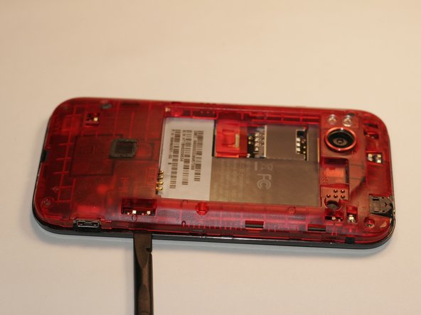

  3. HTC Rezound Front Camera Replacement, Screen: crwdns2935265:03crwdnd2935265:01crwdnd2935265:03crwdne2935265:0 HTC Rezound Front Camera Replacement, Screen: crwdns2935265:03crwdnd2935265:02crwdnd2935265:03crwdne2935265:0 HTC Rezound Front Camera Replacement, Screen: crwdns2935265:03crwdnd2935265:03crwdnd2935265:03crwdne2935265:0
    • Unscrew the six screws (Torx T4 size) shown in the photo.
    • Use the spudger to pry the casing off of the phone.

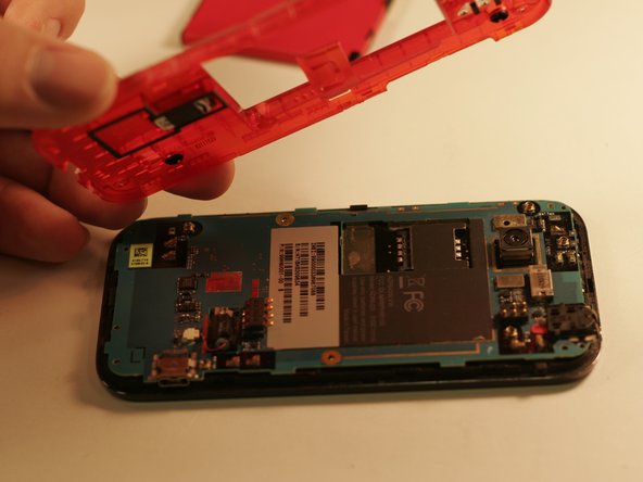

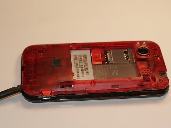

  4. HTC Rezound Front Camera Replacement: crwdns2935265:04crwdnd2935265:01crwdnd2935265:02crwdne2935265:0 HTC Rezound Front Camera Replacement: crwdns2935265:04crwdnd2935265:02crwdnd2935265:02crwdne2935265:0
    • Gently remove the casing from the phone.
  5. HTC Rezound Front Camera Replacement: crwdns2935265:05crwdnd2935265:01crwdnd2935265:01crwdne2935265:0
    • After the red casing is removed, the following components should be visible:
    • Main Camera
    • Headphone Jack
    • Vibration moter

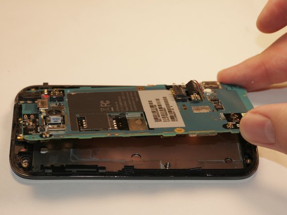

  6. HTC Rezound Front Camera Replacement: crwdns2935265:06crwdnd2935265:01crwdnd2935265:02crwdne2935265:0 HTC Rezound Front Camera Replacement: crwdns2935265:06crwdnd2935265:02crwdnd2935265:02crwdne2935265:0
    • Remove the 2 screws (Torx T7 size), which are located on the upper left and lower right sides of the device.

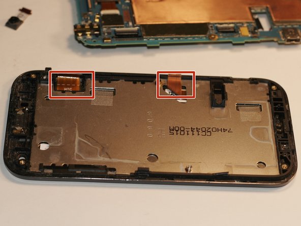

  7. HTC Rezound Front Camera Replacement: crwdns2935265:07crwdnd2935265:01crwdnd2935265:03crwdne2935265:0 HTC Rezound Front Camera Replacement: crwdns2935265:07crwdnd2935265:02crwdnd2935265:03crwdne2935265:0 HTC Rezound Front Camera Replacement: crwdns2935265:07crwdnd2935265:03crwdnd2935265:03crwdne2935265:0
    • Using tweezers, flip the latch on the ribbon cables connecting the logic board to the screen and display. The screen and display for the HTC Rezound are likely fused to one another, so if you are replacing one you will likely need to replace both of them.
    • At this point all that's left is to insert the ribbon cables of your replacement into the same slot on the motherboard!

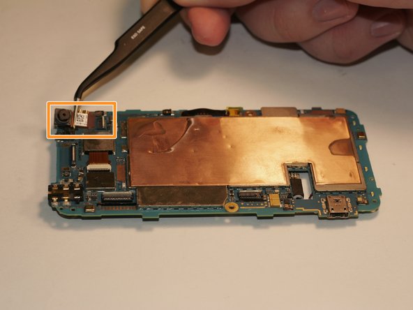

  8. HTC Rezound Front Camera Replacement, Front Camera: crwdns2935265:08crwdnd2935265:01crwdnd2935265:01crwdne2935265:0
    • Shown here is the camera that you will be replacing today!

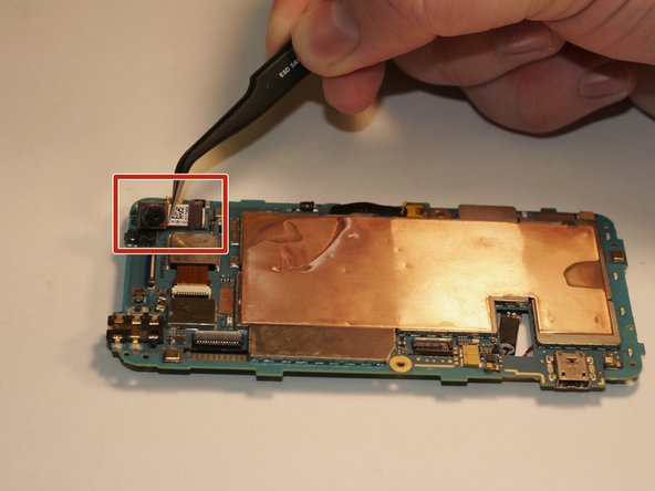

  9. HTC Rezound Front Camera Replacement: crwdns2935265:09crwdnd2935265:01crwdnd2935265:02crwdne2935265:0 HTC Rezound Front Camera Replacement: crwdns2935265:09crwdnd2935265:02crwdnd2935265:02crwdne2935265:0
    • Carefully flip the latch for the ribbon cable that connects the camera to the logic board.
    • Firmly grasp the cable, without crimping it, and slid it out of the slot.
  10. HTC Rezound Front Camera Replacement: crwdns2935265:010crwdnd2935265:01crwdnd2935265:02crwdne2935265:0 HTC Rezound Front Camera Replacement: crwdns2935265:010crwdnd2935265:02crwdnd2935265:02crwdne2935265:0
    • Take the replacement camera and start to line it up with the slot in the logic board.
    • Fix ribbon cable to the slot and turn the latch back down to lock in place.
