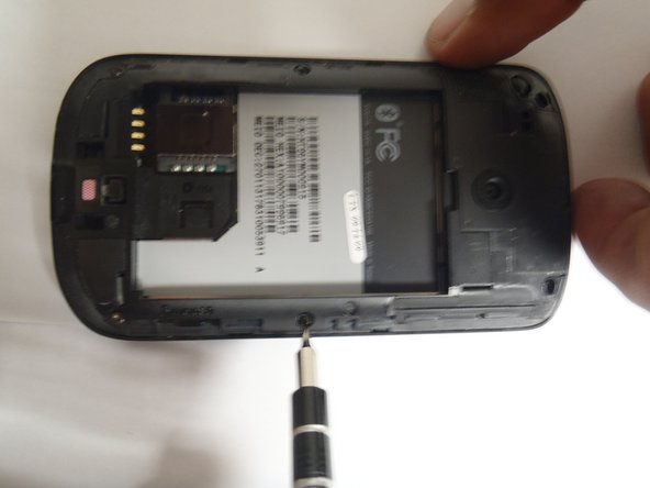

  4. HTC Ozone LCD Display Replacement, Frame: crwdns2935265:04crwdnd2935265:01crwdnd2935265:02crwdne2935265:0 HTC Ozone LCD Display Replacement, Frame: crwdns2935265:04crwdnd2935265:02crwdnd2935265:02crwdne2935265:0
    • Remove the six Torx #5 screws that are securing the rear frame.

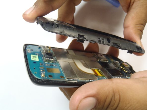

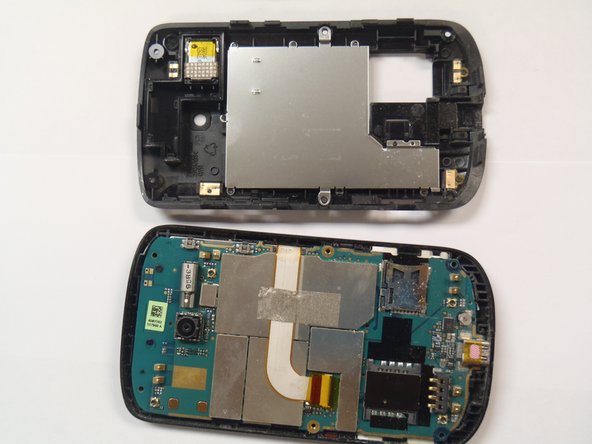

    • Pry the frame open, releasing the eight plastic tabs around the edge of the frame, using the plastic opening tool.
    • A plastic card can be used instead of the plastic opening tool.
