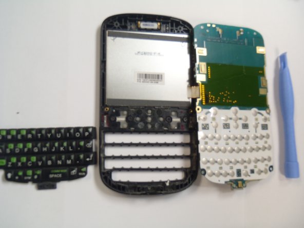

  14. HTC Ozone Keyboard Replacement, Keyboard: crwdns2935265:014crwdnd2935265:01crwdnd2935265:02crwdne2935265:0 HTC Ozone Keyboard Replacement, Keyboard: crwdns2935265:014crwdnd2935265:02crwdnd2935265:02crwdne2935265:0
    • Lift off main keyboard from front plastic case using plastic opening tool.

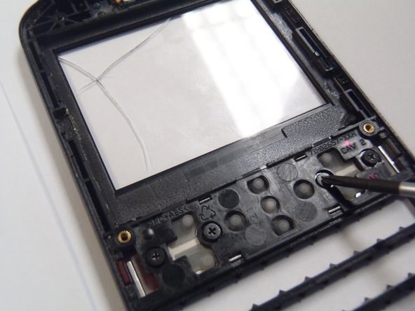

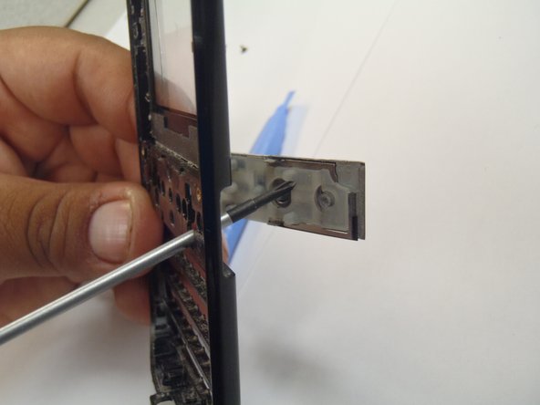

  15. HTC Ozone Keyboard Replacement: crwdns2935265:015crwdnd2935265:01crwdnd2935265:02crwdne2935265:0 HTC Ozone Keyboard Replacement: crwdns2935265:015crwdnd2935265:02crwdnd2935265:02crwdne2935265:0
    • Remove four Phillips #00 screws securing function keys.
  16. HTC Ozone Keyboard Replacement: crwdns2935265:016crwdnd2935265:01crwdnd2935265:02crwdne2935265:0 HTC Ozone Keyboard Replacement: crwdns2935265:016crwdnd2935265:02crwdnd2935265:02crwdne2935265:0
    • Pop keys out by pushing keys from back of the phone.
