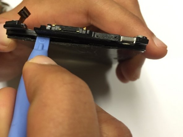

    1. HTC One X Screen Replacement, Disconnecting the digitizer and screen: crwdns2935265:08crwdnd2935265:01crwdnd2935265:02crwdne2935265:0 HTC One X Screen Replacement, Disconnecting the digitizer and screen: crwdns2935265:08crwdnd2935265:02crwdnd2935265:02crwdne2935265:0
      • You must now disconnect the screen and digitzer, which are glued together.
      • You may need to use hot air to heat up the adhesive keeping the screen and digitizer together. This will make separating them much easier.
      • Using a plastic opening tool, slip the tool between the screen and the digitizer and slowly pry them apart.
      • After this is complete, orient your new screen in the same manner as the old one, attach it to the digitizer with a strong adhesive, and reassemble.
