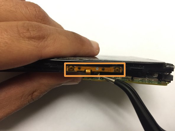

    6. HTC One X Button Replacement, Disconnect flex cables: crwdns2935265:06crwdnd2935265:01crwdnd2935265:03crwdne2935265:0 HTC One X Button Replacement, Disconnect flex cables: crwdns2935265:06crwdnd2935265:02crwdnd2935265:03crwdne2935265:0 HTC One X Button Replacement, Disconnect flex cables: crwdns2935265:06crwdnd2935265:03crwdnd2935265:03crwdne2935265:0
      • Place the battery back into its original position once the PCB board has been removed
      • Use tweezers to disconnect the power button flex cables.
      • Disconnect the volume flex cable by opening the gate and then sliding the cable out using tweezers.
      • Disconnect the touchscreen flex cable
      • If repairing hard buttons, skip step 7.

    1. HTC One X Button Replacement, Ensure flex cables and buttons are connected: crwdns2935265:08crwdnd2935265:01crwdnd2935265:02crwdne2935265:0 HTC One X Button Replacement, Ensure flex cables and buttons are connected: crwdns2935265:08crwdnd2935265:02crwdnd2935265:02crwdne2935265:0
      • Ensure that the power button flex cable from Step 6 is connected securely with its base.
      • Ensure that the volume flex cable from Step 6 is connected securely with its base.
      • If necessary you may need to replace these flex cables completely.
      • Follow these steps in reverse and specifically check the power and volume buttons as they're placed into the phone.
