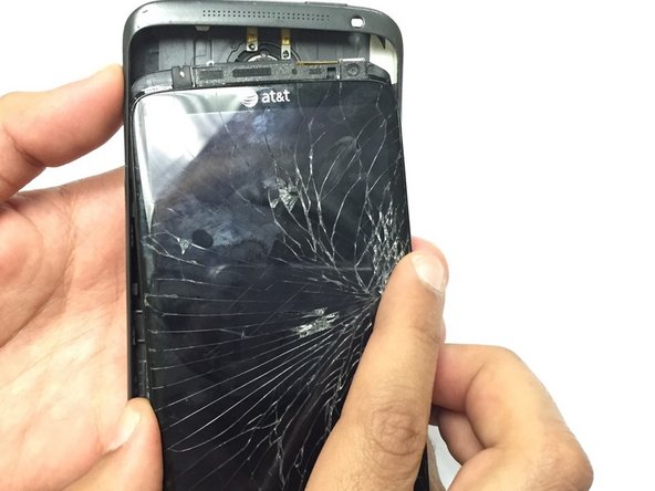

    3. HTC One X Antenna Replacement, Remove front panel: crwdns2935265:03crwdnd2935265:01crwdnd2935265:02crwdne2935265:0 HTC One X Antenna Replacement, Remove front panel: crwdns2935265:03crwdnd2935265:02crwdnd2935265:02crwdne2935265:0
      • Use a plastic opening tool, and carefully insert it between the display and rear panel. Separate the two parts.
      • The display assembly is a tight fit therefore the removal must be carried out carefully with firm, constant force being applied around the bottom corners and sides of the panel. Note that the top of the phone is underneath the panel, and will not come out.
      • If your display is cracked, take extra caution when separating the display from the rear panel to prevent further breakage or bodily harm.
      • Set aside the rear panel for now
    4. HTC One X Antenna Replacement, Replace antenna: crwdns2935265:04crwdnd2935265:01crwdnd2935265:01crwdne2935265:0
      • Once the rear panel is separated from the front panel, remove the antenna using tweezers.
      • The antenna is located on the right hand side of the front panel as indicated in the image.
      • Replace and reconnect the new antenna in the same position as the faulty one you just removed. Remember to place it underneath the metal supports on the board.
