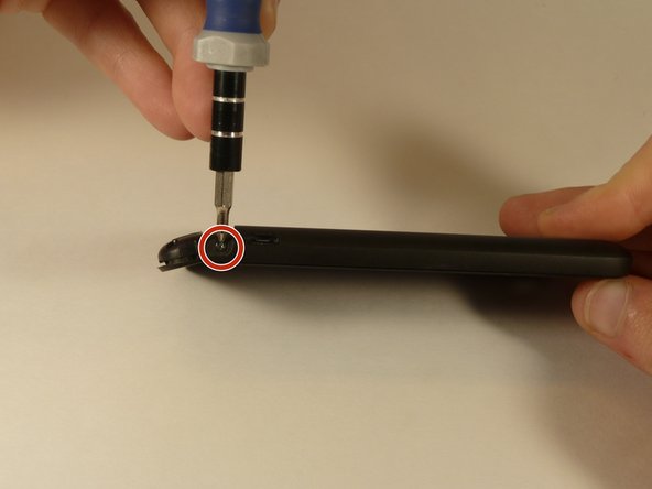

    • Remove the SIM card.
    • Remove the four screws securing the bottom casing.
    • Two 3.0 mm Phillips #0 screws in the top left and right corners.
    • Two 2.0 mm Phillips #0 screws in the bottom left and right corners.

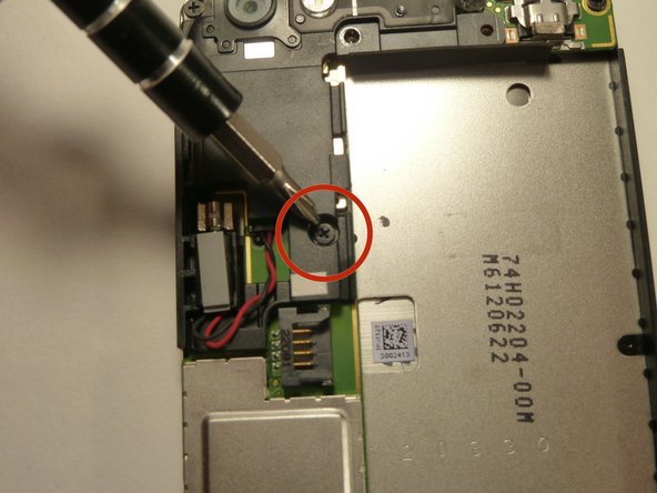

    • Use the plastic opening tool to pry open the rear camera panel.
    • Remove both screws that are securing the back case.
    • One 4.0 mm Phillips #0 screw.
    • One 3.0 mm Phillips #0 screw.

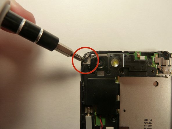

    • Remove the two 3.0 mm Phillips #0 screws, that are securing the camera lens.
  11. HTC One V Vibrator Replacement: crwdns2935265:011crwdnd2935265:01crwdnd2935265:01crwdne2935265:0
    • Pry off the camera lens using a plastic opening tool.

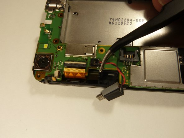

    • Pry the vibrator out of the housing with a spudger.
    • Using the tweezers, pull up on the connecting wires detaching the vibrator from the motherboard.
