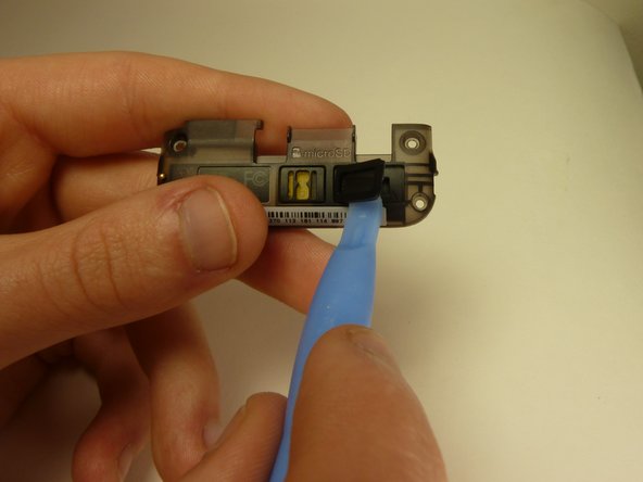

    1. HTC One V Loudspeaker Replacement, Loudspeaker: crwdns2935265:05crwdnd2935265:01crwdnd2935265:02crwdne2935265:0 HTC One V Loudspeaker Replacement, Loudspeaker: crwdns2935265:05crwdnd2935265:02crwdnd2935265:02crwdne2935265:0
      • Using a plastic opening tool, peel off the speaker cover.
    2. HTC One V Loudspeaker Replacement: crwdns2935265:06crwdnd2935265:01crwdnd2935265:01crwdne2935265:0
      • Use the spudger to push the speaker out of its casing.
